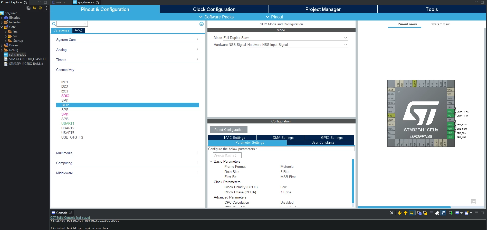

I am trying to get 2 stm32f411's to communicate via SPI. From my understanding, there should be 1 master device while the others should be its slaves.

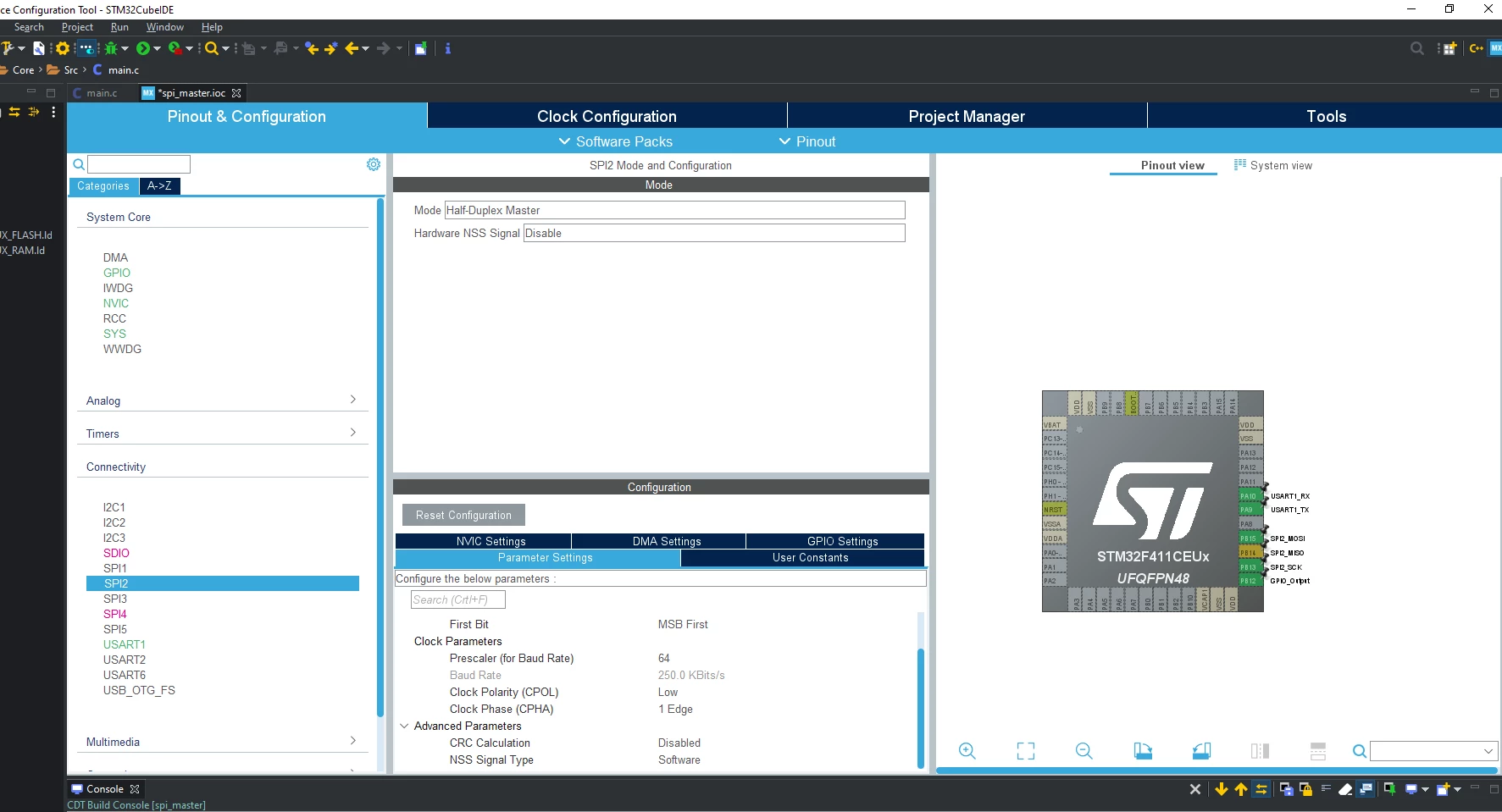

For my master device, I am using full-duplex master and I have disabled NSS and enabled the NSS pin as an GPIO OUTPUT pin.
For my slave device, I am using full-duplex slave and have enabled NSS INPUT SIGNAL so it knows when it needs to read.
Here are my problems:
  1. I have set the prescalar of the master device to 64 but am unable to set the prescalar of the slave device as there is no option to do so. I am unsure if this is a problem as I have seen an example where it is possible to set the prescalar for the slave device. However, am I unsure if it is necessary as the option disappears for me every time I set a device to slave.

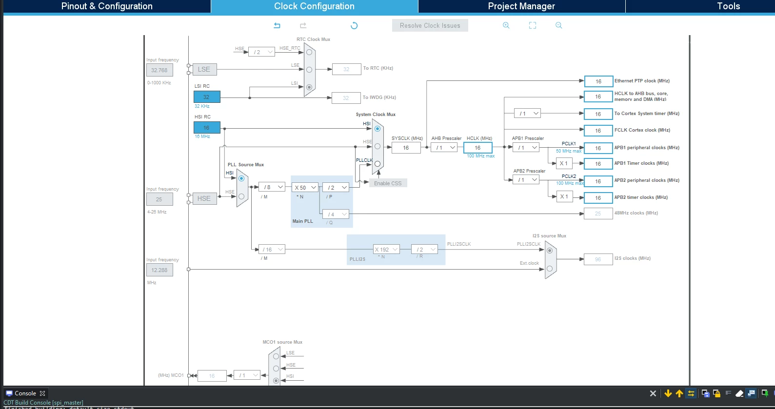

  2. I am unsure if I need to change anything in the "clock configuration". I noticed that there is a option to enable PLLCLK for CSS but I am not sure if I need to do this or if leaving it set to HSI is ok.
  3. I am unable to send and receive any data.
Here is a screenshot of the clock configuration I am talking about.0693W00000Hoa3nQAB.png

Also, please let me know if there are any good and detailed guides on spi, i2c, uart, etc.
Thank you very much for your time and help!

the slave gets its clock from the master, you don't setup a slave clock.
