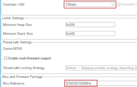

I used CubeMX to generate CMake project for STM32H750XBH6.

 But everytime I use CubeMX regenerate the project, STM32H750XBHx_FLASH.ld will be recovered. My changes didn't save.
How can I save this modified STM32H750XBHx_FLASH.ld when CubeMX regenerates project?

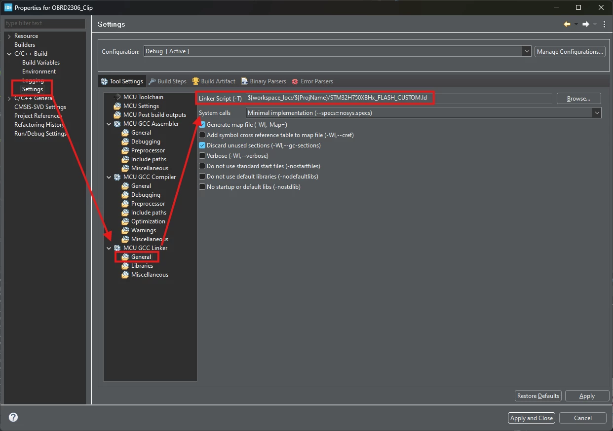

    July 9, 2024
    Or, as a alternative you can create a new file STM32H750XBHx_FLASH_CUSTOM.ld with the modifications you want in it. And use this one as the linker script in your project configuration :
    Then on your next CubeMX generations, the STM32H750XBHx_FLASH.ld will be regenerate but not the STM32H750XBHx_FLASH_CUSTOM.ld which will still be the one used by your compiler.
    Nobody233Author
    July 10, 2024
    Hi, @SMarie .
    Thanks for your reply.
    Sorry about the point that I didn't mentioned is I'm using VS Code.
    And I found another solution for VS Code, see upper floor.
    Thanks for your kindness.
