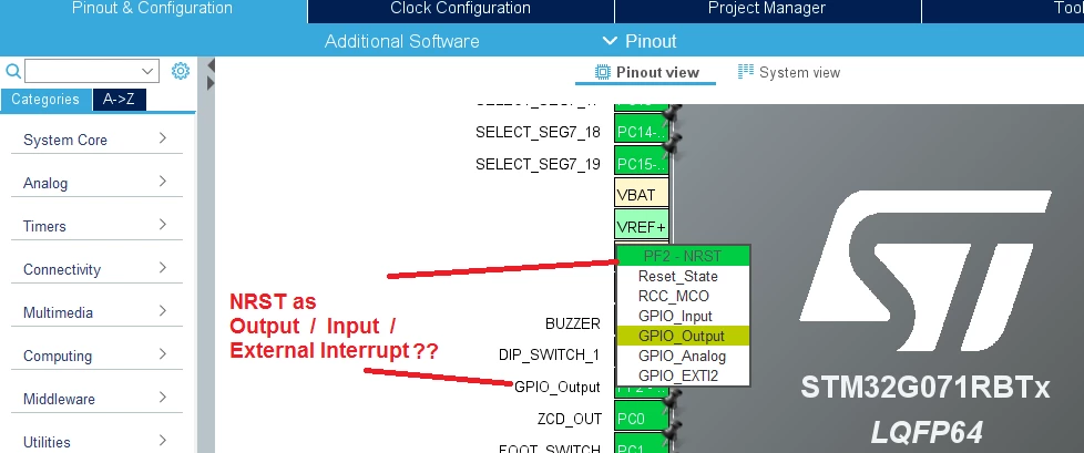

Unable to Configure : STM32G071R8 NRST as Input/Output/Interrupt
I am working on STM32G0 Nucleo Board with STM32 Cube IDE 1.3.0
How to configure STM32G071R8 64-Pin LQFP Package
as Input or Output or Interrupt with STM32 Cube IDE 1.3.0 . ?
Is there any special setting ? Which I am missing ?
Karan
TDKBest answer
Jul 11, 2020 2:50 PM UTC
Change the NRST_MODE option bits to 0b10 using STM32CubeProgrammer to disconnect that pin from internal NRST. See info in the reference manual.

Karan 123
Karan 123Author
Senior
Jul 11, 2020 2:58 PM UTC
Thanks..Solved..

One More question , Is there any way to Program Option Bytes for NRST_MODE  and Program Lock (Read Out Protection Byte ) in .c file ?
Jul 11, 2020 4:14 PM UTC
Yes, look at HAL_FLASHEx_OBProgram. You need to unlock option bytes first. Should be examples in the CubeG0 repository.
It's also possible to change them during programming via the linker file, but that's a bit more complicated to set up.
