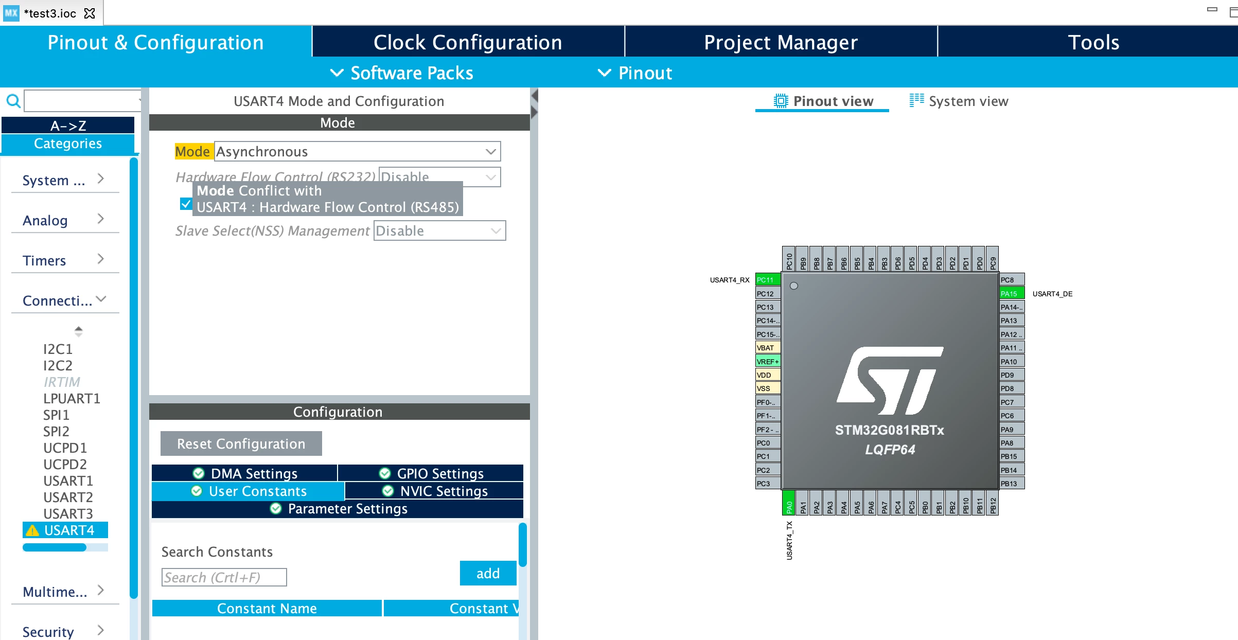

Datasheet indicates DE is supported on all 4 USART interfaces, but attempting to enable it for USART4 in STM32Cube results in an error:
Mode Conflict with
USART4 : Hardware Flow Control (RS485)
Steps to reproduce:
  1. Create new project based on STM32G081RB
  2. Open the IOC file
  3. Navigate to Connectivity -> USART4
  4. Set Mode to Asynchronous
  5. Select Hardware Flow Control (RS485)

Thanks @MJ​, for bringing this up.
 I can confirm this erroneous warning, however it does not seem to have any effect on the generated code.

Hello @MJ​ ,
Thanks for your feedback,
This issue does not effect the generated code but the warning message is not supposed to be shown, with this being said, a Ticket has been submitted internally to solve this issue.
