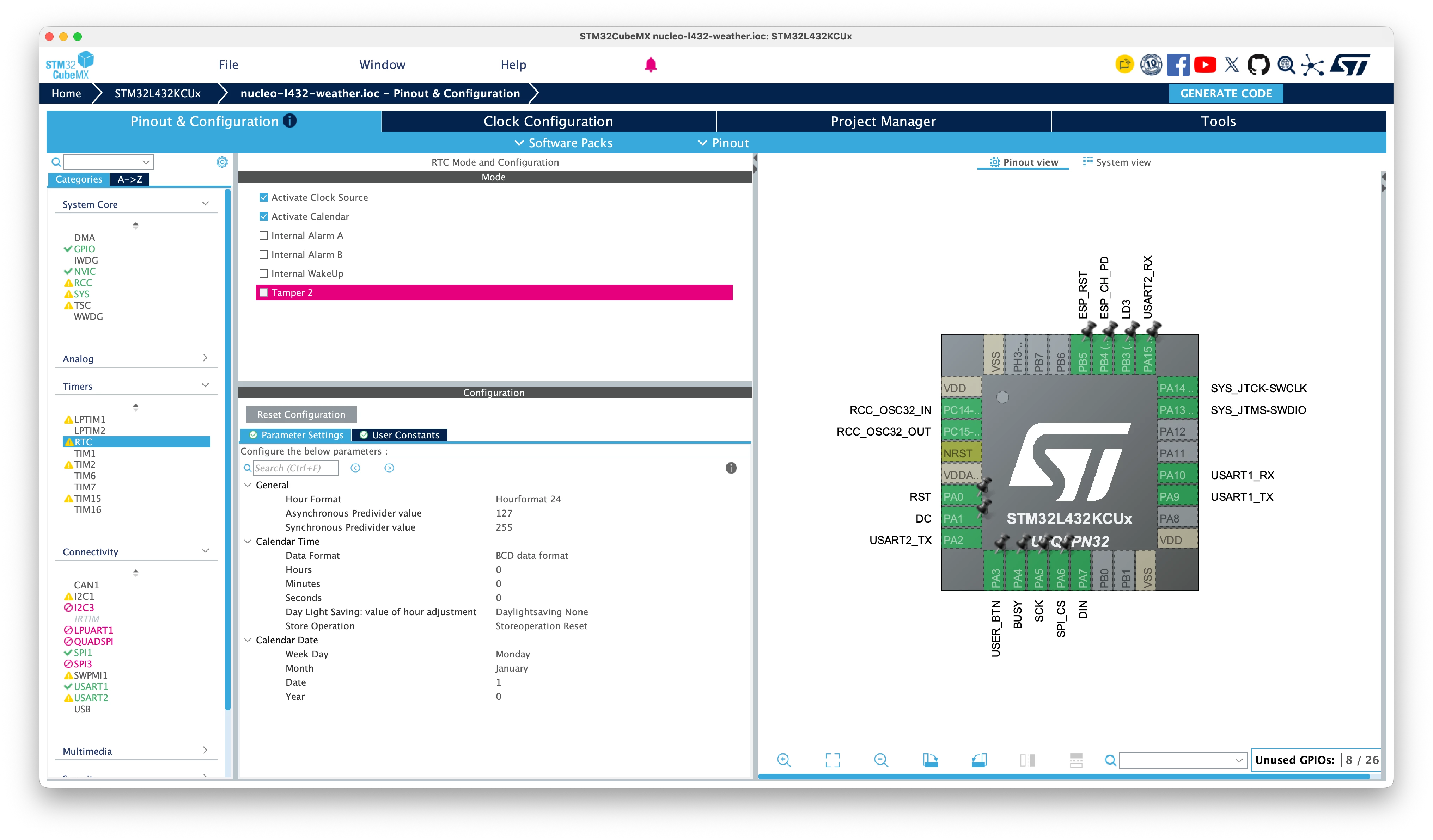

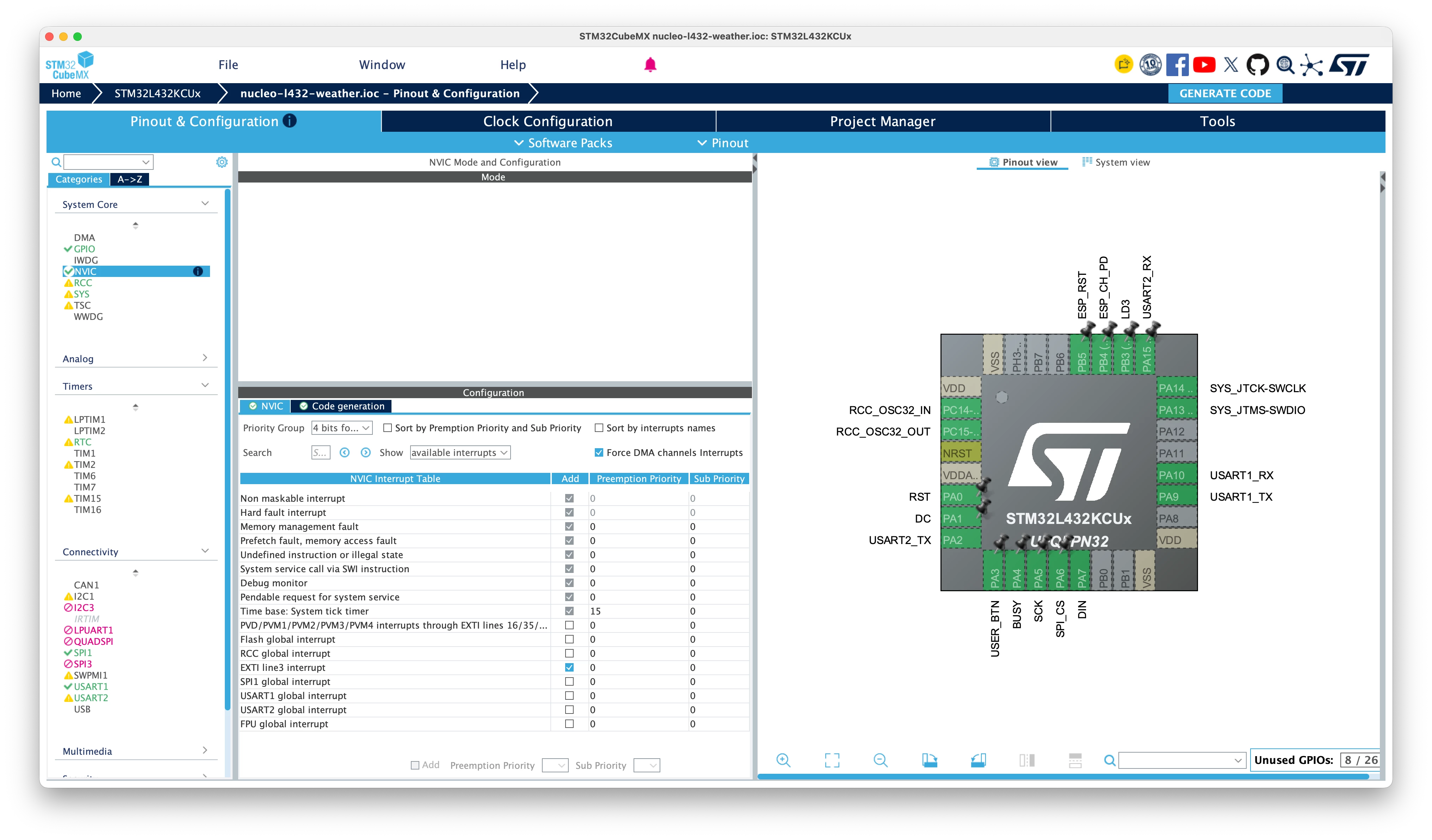

Hi Everyone,
after enabling RTC for the STM32L432KC in STM32CubeMX (version 6.18.0) RTC_WKUP_IRQn doesn't show up in the CubeMX NVIC panel for this MCU but is present in the vector table.
Is that a bug or am I missing something?
Best regards
GolfBravo
RTC configuration
Missing RTC wake-up timer interrupt through EXTI line 20?

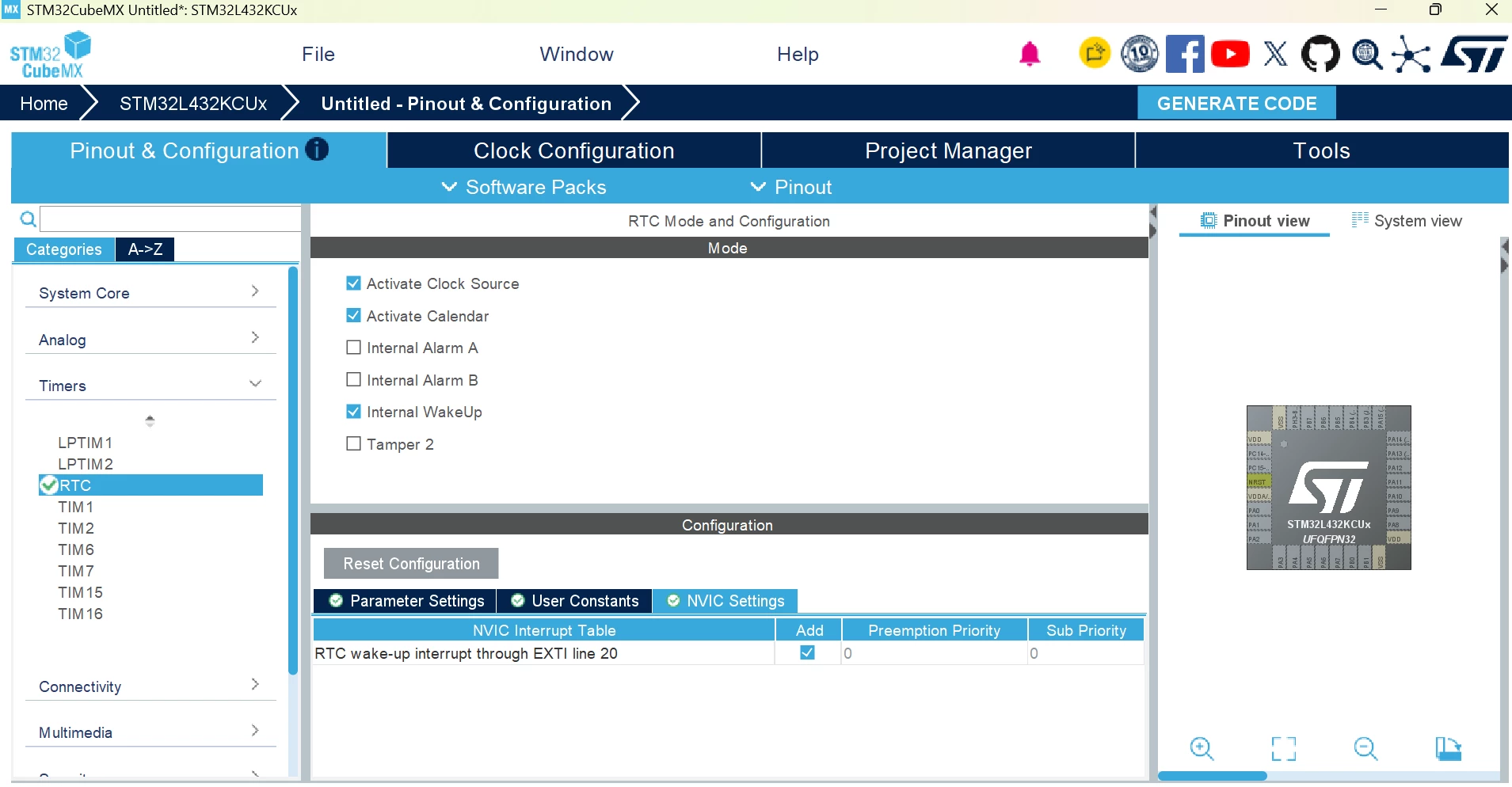

Hello ​@GolfBravo
 You need to activate Internal WakeUp first.
THX
Ghofrane
