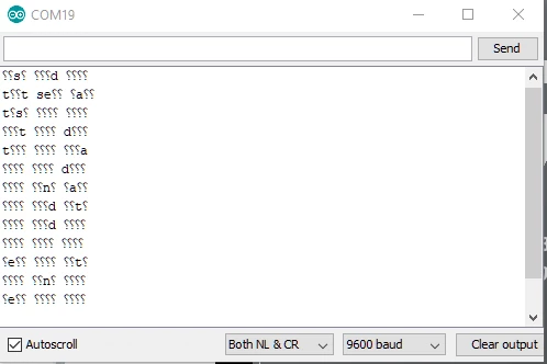

UART transmit error character
0690X00000ArRaqQAF.png0690X00000ArRb0QAF.png0690X00000ArRbAQAV.png0690X00000ArRb5QAF.pngHello,
i have problem for using STM32H743VI. start from the basic problem, that is transmit UART standard. i use latest firmware of STM32H7 version 1.5.0, latest update STM32CUBEIDE 1.1.0 and latest update STM32CUBEMX 5.3.

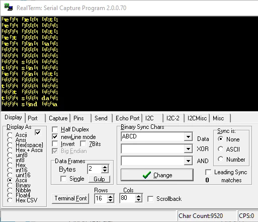

the output is showed by image that i attach here. please any help?
Thankyou very much.

Oct 30, 2019 10:53 AM UTC
Timing looks close.
Hows this all connected from STM32 to PC?
The STM32 doesn't output RS232 compatible voltages, needs MAX3232 or similar to do voltage conversion/inversion.

mal hAuthor
Oct 30, 2019 10:59 AM UTC
Thank you for the response.
i use IC ft232rl for converting UART to USB. and the USB plug into laptop and receive data with software (Realterm and Serial Monitor Arduino). i have done with this method for another STM32 IC like STM32F3 on another project. but, it stuck here for STM32H7.

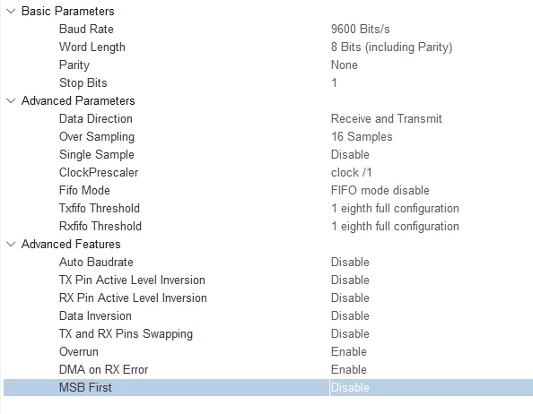

RMcCa
Senior II
Oct 30, 2019 12:20 PM UTC
I had uart trouble with an f7 ​after switching from hsi to hse oscillators. Turns out hal was not calculating the baud rate correctly, so i just wrote my own initialization routine with the correct baud rate hard coded. I don't trust hal.

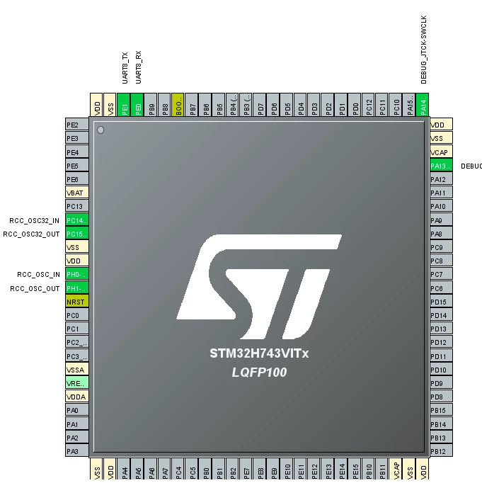

mal h
mal hAuthorBest answer
Oct 30, 2019 12:47 PM UTC
Thanks guys for the answer..
i got the problem. First, yes timing/clock problem. So, i switch manually from HSI to HSE for clock source. little bit tricky, but nice learn. Thank you.
