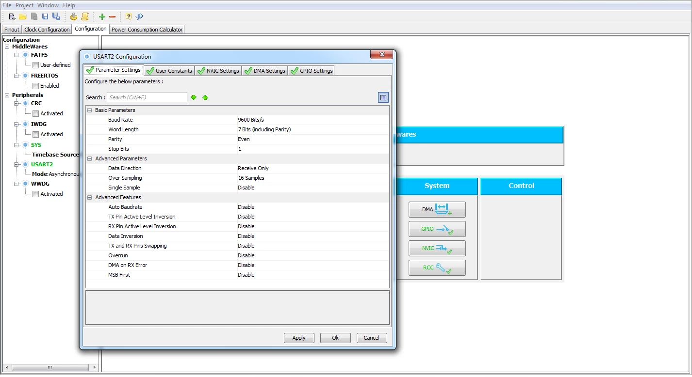

I am setting up communication via USART2 Asynchronous to receive my data. Configuration for receive the data is 9600/7bit/1-bit stop/Parity Even/Mode Rx/Tx. The implementation works fine when no parity is implemented. But the specification dictates that even parity should be supported. If added the parity, I received any value.I do not understand where is the problem. My configuration is with STMCubeMx for STM32L031K6 nucleo.

Observe that it say ''7 bits including parity'', for 7E1 you need to specify 8-bits with parity. And you will want to mask the data read from the Receive Data Register.
At the moment you are configuring 6E1

Thank you for your reply,
I did not understand, the data is 7-bit with party so I have to 8 bits (Including party) why? and why do my mask register is on how much? and after i add huart2.Init.Parity = UART_PARITY_EVEN; or No . thnks
Tesla DeLorean
Guru
Jun 24, 2016 2:57 PM UTC
Posted on June 24, 2016 at 16:57
Because that's how the hardware was designed and works.
7 + 1 = 8 data = USARTx->RDR & 0x7F; // To ensure the high order bit is not reflected in the data read For 7E1
huart2.Instance = USART2;
huart2.Init.BaudRate = 9600;
huart2.Init.WordLength = UART_WORDLENGTH_8B;
huart2.Init.StopBits = UART_STOPBITS_1;
