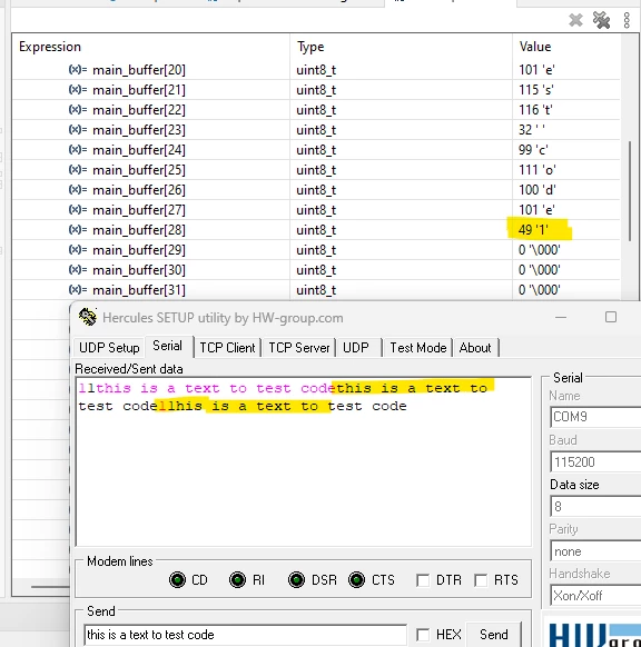

I used it, first it sent just one time then I also call it in HAL_UARTEx_RxEventCallback at the end. It work exactly what I want I meant when I send a data from UART1 it sends data back from UART6. However, when I send new data it writes it first byte and sends new data and the data I sent before it. I want to receive only last data.
_legacyfs_online_stmicro_images_0693W00000biAKvQAM.pngIt receives 1 and then changes first byte of the data I sent before 1, and transmite them together.
I receive data with rx_buffer but store whole data sequentially in main_buffer. I tried to transmit both of them but nothing change.
HAL_UART_Transmit_DMA(&huart6,rx_buffer, sizeof(rx_buffer));

Karl Yamashita
Karl YamashitaBest answer
Principal
April 16, 2023
From what i see, main_buffer is pointless as you are not doing anything with it.
My UART2 is your UART1 and my UART1 is your UART6 which this is working on a Nucleo-L432 board
uint8_t tx_buffer[rx_buff];
void HAL_UARTEx_RxEventCallback(UART_HandleTypeDef *huart, uint16_t Size)
	if (huart->Instance == USART2)
		/* start the DMA again */
		memset(&tx_buffer, 0, sizeof(tx_buffer)); // clear tx buffer
		memcpy(&tx_buffer, &rx_buffer, Size); // copy only what was received
		HAL_UART_Transmit_DMA(&huart1, tx_buffer, Size); // use Size instead of sizeof(rx_buffer)
		HAL_UARTEx_ReceiveToIdle_DMA(&huart2, (uint8_t *) rx_buffer, sizeof(rx_buffer));
If a reply has proven helpful, click on Accept as Solution so that it'll show at top of the post.CAN Jammer an open source CAN bus hacking toolCANableV3 Open Source
MÇETİ.1
MÇETİ.1Author
April 17, 2023
Thank you so much!!!! It works!!
