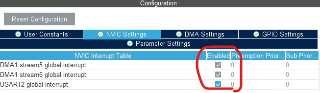

Hi Team
UART DMA not works with STM32F767ZI and STM32F745VE.
It does not transmit or receive data.
Testing same code with STM32F405 and STM32G474, UART DMA works fine.
Does anyone know why UART DMA doesn't work on STM32F?
Is there anything to be care of RAM setting when use UART DMA?
My dev. environment:
  • STM32CubeIDE Ver1.8.0
  • FW Package Ver: FW_F7 V1.16.2
Below is my test code.
※This code will not work unless the DMA and UART interrupts are enabled.
​0693W00000KaLImQAN.png​

Kenji1Best answer
Senior
Feb 25, 2022 6:34 AM UTC
Hi everyone.
I found the cause of this problem.
There was STM32CubeIDE (CubeMX) generated code bug!
If UART is initialized before DMA, UART DMA will not work.
The UART should be initialized after DMA.
For example, this initialization sequence, UART DMA doesn't work.
MX_UART4_Init();
MX_UART5_Init();
MX_DMA_Init();
And, this initialization sequence, UART DMA work.
MX_DMA_Init();
MX_UART4_Init();
MX_UART5_Init();
As far as I tested, behavior is same on STM32F4 / G4 / F7.
This is a bug of STM32CubeMX code generation.
I hope this will fix by STMicroelectronics.

DDurk.1
Feb 25, 2022 12:57 AM UTC
I had a similar issue, for me it was the interrupt priority settings on the NVIC tab under Pinout and Configuration in CubeMX. Lower numbers are higher priority. I would also check the clocks for the USARTS to make sure they are adequate, check the baud rates etc are the same and the GPIO speeds on the USARTS are adequate.
