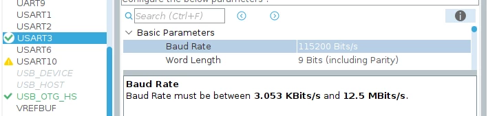

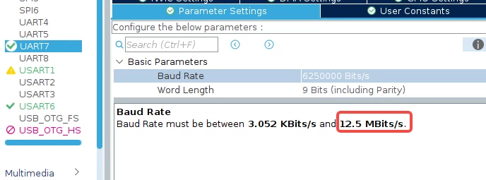

I have a uart peripheral whose baud rate can only be set to 3.125M. However, the baud rate of another uart peripheral with the same clock configuration in the project can be set to 12.5M. I want to know what the baud rate limit is based on? How to increase the baud rate from 3.125M to 12.5M?

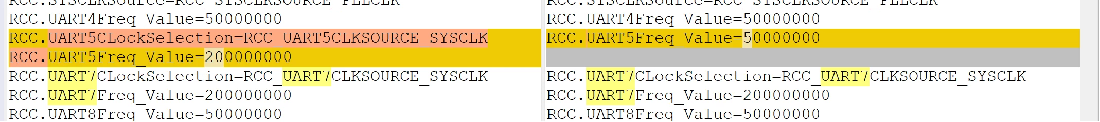

CubeMX is using the UART5 clock selection to determine the acceptable UART7 speeds. Clearly a bug. In MCUA it's set to SYSCLK=200MHz but in MCUB it's set to PCLK1=50MHz, hence the difference in behavior.
Easy workaround: enable UART5, set the clock selection to SYSCLK to match that of UART7, then disable UART5.

But in pics you show : different speed limits, but for same peripheral - how this can be at same parameters and clk ?
but
I  can do same :
and :

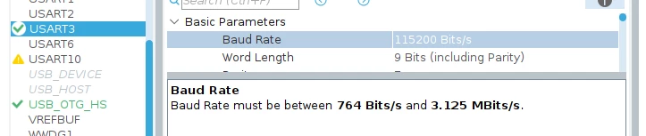

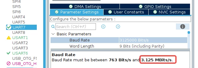

In my project, two identical MCUs need to cross-communicate, but the upper limit of the baud rate of MCUB is limited, which troubles me.
Since i am not allowed to send ioc files, I took screenshots of the clock and uart configuration of the two chips. In addition, I am using the linux version(1.12.0) of CubeIDE.
MCUA
MCUB
Thanks.

It appears there is a bug with how CubeMX is calculating the max rate here, as it isn't adjusted for the selected clock source. There's probably a workaround, but I can't duplicate the issue. Seeing your IOC files would be insightful.
TDKBest answer
Dec 21, 2023 4:53 AM UTC
