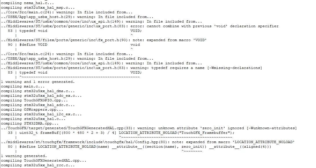

Hi, I saw the latest post about USBX baremetal now being possible and thought i would give it a try.

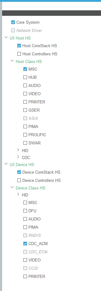

I want to read USB drives and usb uart port to PC for comms.
but get the following errors in uVision when compiling

So it's because of the silly void * ? Can you just change the definition in fx_port.h to match the other one?

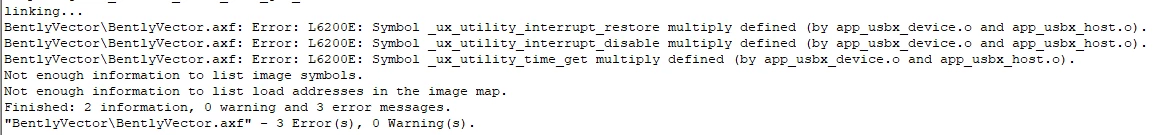

I did that and now its throwing multiple defines
