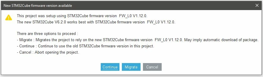

WilkoL
WilkoLAuthor
Senior
Mar 11, 2021 10:22 AM UTC
Hello Khouloud,
Thanks for your reply. The problem with the line LL_ADC_EnableInternalRegulator(ADC1) is solved in the latest firmware FW_L0 V1.12.0 .
I noticed that after re-opening the .ioc file STM32CubeMX wanted to upgrade. After letting it do that, it now produces the correct code.
Odd though, is that I do not see that it does upgrade the firmware, see picture.

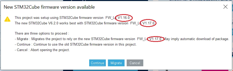

Khouloud OTHMAN
Mar 11, 2021 11:24 AM UTC
Hi @Community member​ ,
First let me thank you for the correction of the first problem confirmation :smiling_face_with_smiling_eyes:
To explain briefly the message behind this warning popup: On project load, STM32CubeMX detects if the project was created with an older version of the tool and if this is the case, it proposes the user to either migrate to use the latest STM32CubeMX database and STM32Cube firmware version, or to continue.
You can select continue to use original firmware used at project creation and in this case it will downloaded into your repository as well as the MCU and IPs database, or you can select migrate, and in this case your project will be modified to fit the current database definition.
It is a bit odd that this warning window is displayed while working with latest version of firmware. The expected behavior is as in the picture attached below (two different versions of firmware):
Could please describe how did you reproduce to get this pop up? It will be really helpful for us to track the root cause of this misbehavior.
