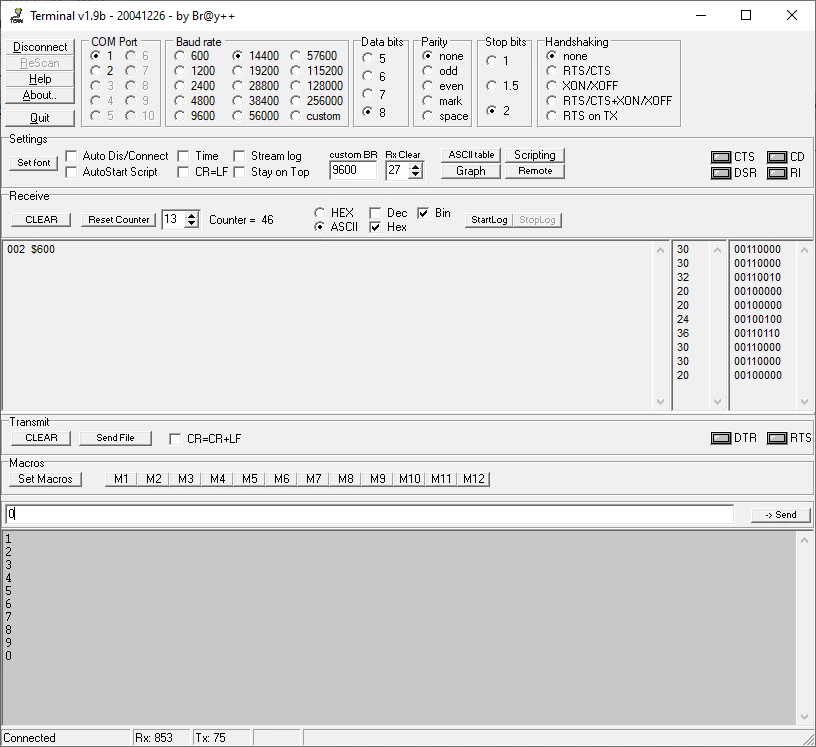

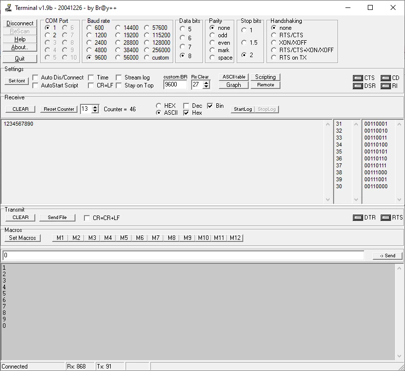

Trying to understand why USART is not working properly on high baud rates
While USART (receive from PC and transfer of gained information back, pic. 1) perfectly works on low baud rates like 9600, use of high baud rates leads to obscure results (bad receive and OK transmit, pic. 2)

Higher rates are less tolerant to jitter or clock mismatch. Although 14400 shouldn't be a problem. Check to make sure the clock is accurate, pipe MCO out and measure frequency. If you're using HSI, ensure HSITRIM is set properly per the datasheet/reference manual.

Not sure I can measure frequency (the only tool I have is logic analyzer).
Also tried to use different clock sources (including HSI) but no change.
Is there anything else that can cause the problem?

This is exactly how a mismatch in clock rates would manifest. A logic analyzer will be enough to show the signal rate on the line. Double check that the speed, parity, and stop bits settings are identical on both the STM32 and the receiving PC.
Then observe the USART pins using that tool.
What do you use as interface between STM32 and PC?

FT232R, if I'm not mistaken

OK and now show the waveforms on the STM32 UART pins observed by the logic analyzer.

Even your LA does not receive the data properly, why do you think this is problem in STM32?
Check your ground connections. Try using a different UART/USB transceiver.
Jul 14, 2021 1:10 PM UTC
The STM32 TX looks perfect. The PC TX isn't a valid UART signal at any baud rate, but that's not the fault of the STM32.
