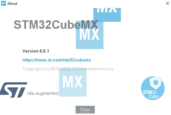

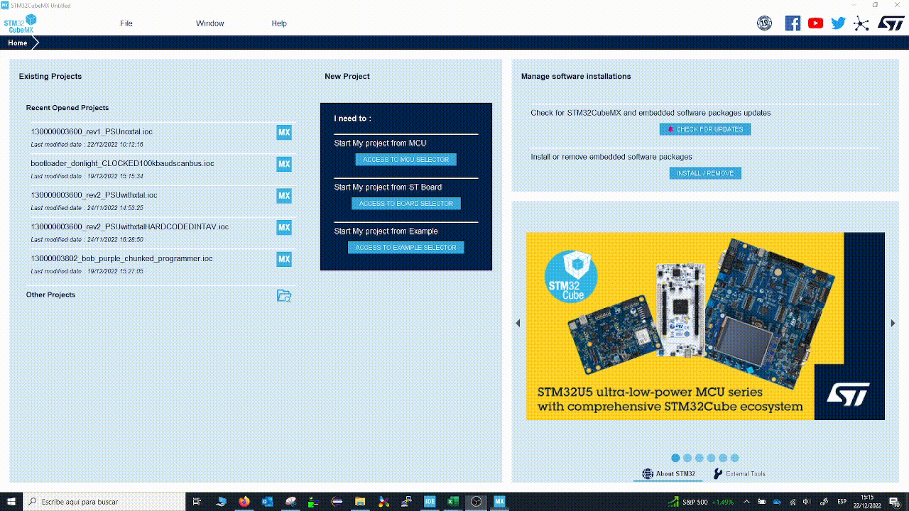

Is not a new installation of CubeMX v6.6.1, it has been working so far, untill today i try to File>New project.... and stays here forever
trying to unzip "cube-finder-db.zip"
