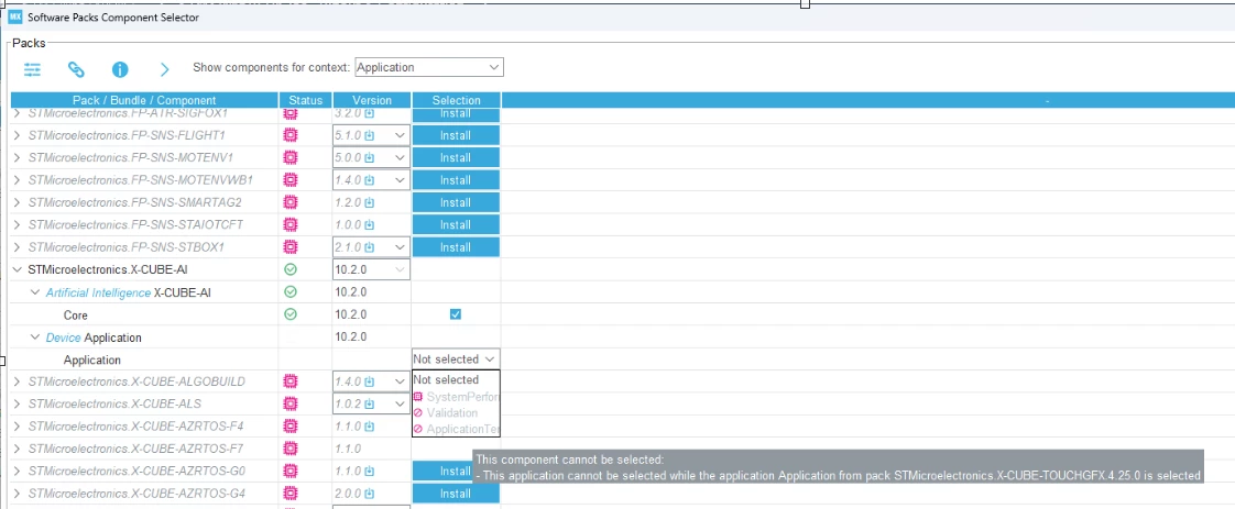

I have a project with TouchGFX based on STM32N6570-DK.
In STM32CubeMX, once I tried to add X-CUBE-AI, I got stuck, and the error is appeared as shown below.
What does it mean?
Once I removed the TouchGFX Graphic Application, the X-CUBE-AI can be enabled, but the generator removed MX_TouchGFX_Init() etc.
Are there any side effects, if I restore the TouchGFX code manually?
And I’m curious — why does this limitation exist?

Hello @ERROR
Actually, X-Cube-AI and touchGFX cannot be used simultaneously. The explanation has already been discussed in this thread.
KR,
Souhaib
