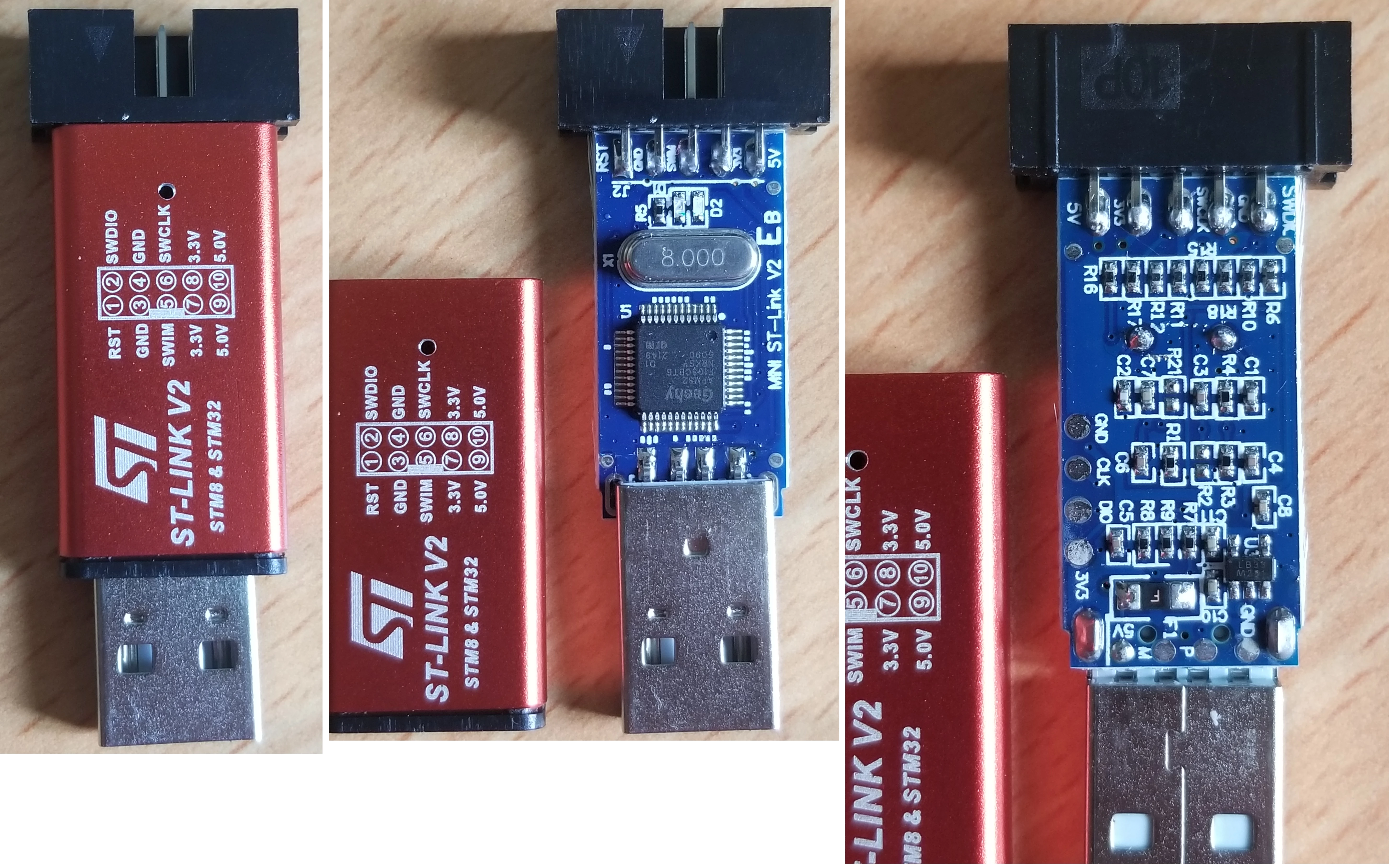

We already have other PCBs built but do not have the firmware loaded on these. We have an upcoming opportunity where this piece of equipment will not be in use during production and we would like to seize this opportunity to create a backup copy of the existing firmware in order to ensure we can continue to use and maintain the equipment in the future.
I would like to mention that I already have experience with Arduino, Teensy, ESP32, and Raspberry Pi development, but not with the STM32 development environment. Additionally, we have a number of debugging devices left, which can be seen in the attached images, but we are unsure if these are genuine and if any of these can be used for this task. Any suggestions or advice on how to proceed would be greatly appreciated. Thank you in advance for your help.

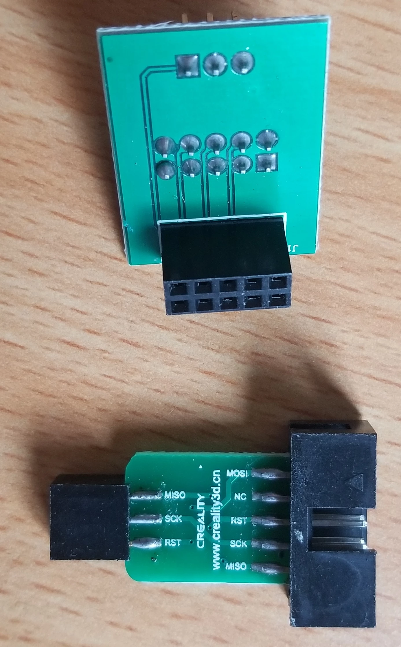

1 Bootleg ST-LINK/V2
2 Bootleg USB ISP (AVR / Arduino?)
3 Some STC15W204S 8051 adapter
4 FTDI Serial adapter
5 Segger J-Link
6 Serial adapter cable

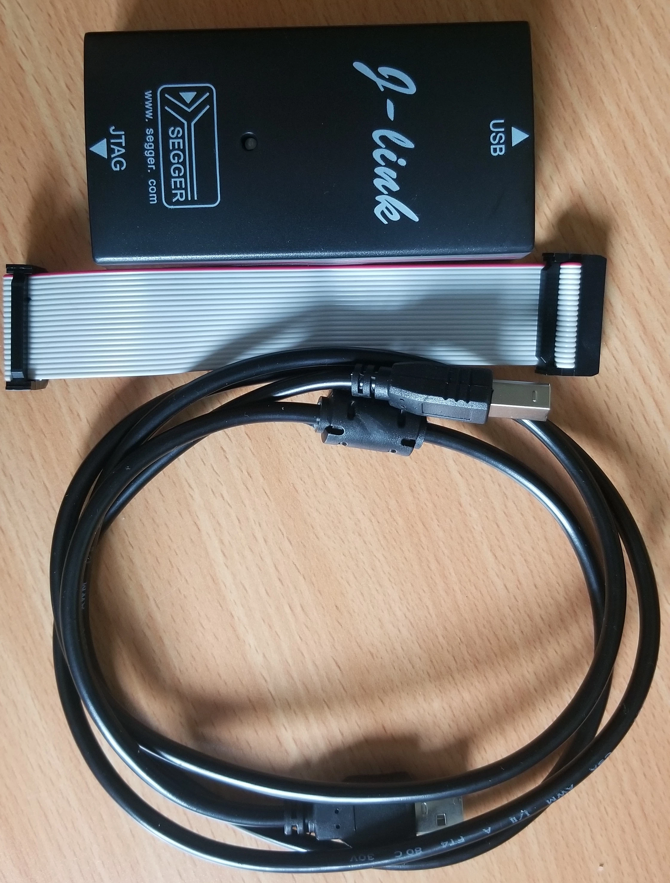

The J-Link or ST-LINK/V2 would perhaps be most use.
The ST-LINK/V2 with STM32 Cube Programmer or ST-LINK Utilities should be able to pull firmware from an unprotected STM32F103
The system boot loader mode for the STM32F1 might be usable via a serial adapter, and STM32 Cube Programmer in COM/UART connectivity mode. Reset STM32 with BOOT0 pin pulled high. Access via USART1 PA9/PA10 (see also app note AN2606)

In order to ensure successful firmware retrieval during the scheduled production stop, I need to prepare properly. You confirmed my suspicion that some of the devices may not be genuine, but rather clones. Can you please advise on the best way to ensure that the devices you recommend will be reliable for the 12-hour window I have been given?
This project is putting a lot of pressure on me, and I am somewhat nervous about the possibility of bricking the device. I have access to some other boards and PCBs with older, non-functioning firmware that I can use for testing. I may perform a practice run in the coming days and provide an update.
To that end, I have opened up the Segger J-Link and taken photos of its internals and rear. I have concerns that this device is also a cheap clone and not an original. This raises questions about whether our previous engineer took the genuine devices and left us with the fakes, which would add to our difficulties. I do not have enough evidence to make an accusation, but I do wonder if this is a possibility.

ACra.1
ACra.1Author
February 3, 2023
Yeah,
suspicion confirmed. All of the devices left behind are cheap clones.
Just received the paperwork from our purchasing department, that shows the Segger J-link purchased 3 years ago from OEM.
So he did leave taking the originals then, leaving me with the scraps.
Well guess I give the clones a try with the older spare revisions, to see if this can be done at all.
Will post updates in the coming days, regarding connections and config.
