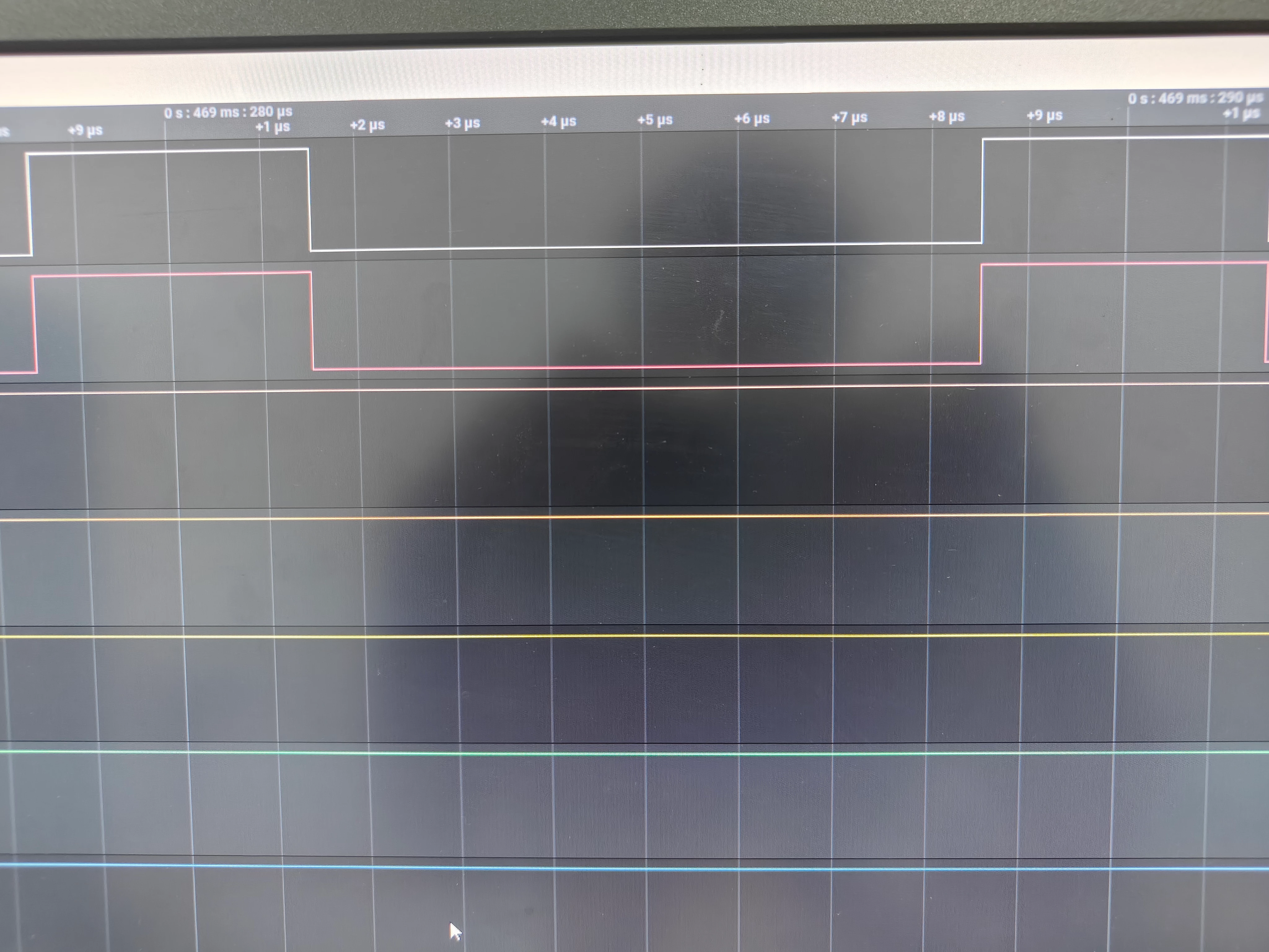

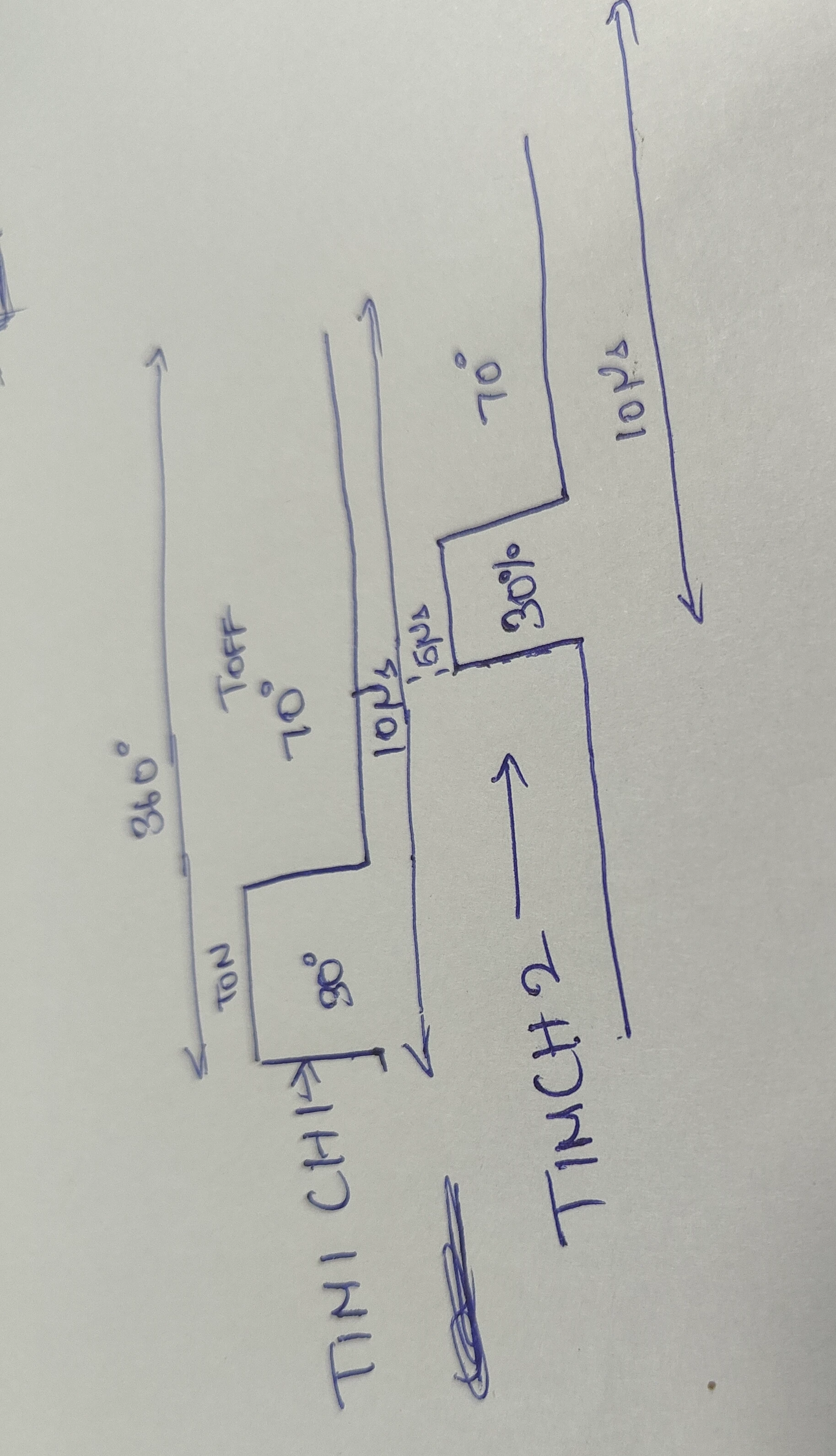

logic analyser picture has timer 1 channel 1 and another one is channel 2 it's duty 30% and frequency 100khz it's total ton+toff is 10 microseconds here I need to start the timer 1 channel 2 after 5 microseconds  I need the output like this I I'm drawn here
im using STM32H743IGT6 I had got the output in 50% duty but I can't get output other than 50% duty please help me anyone.

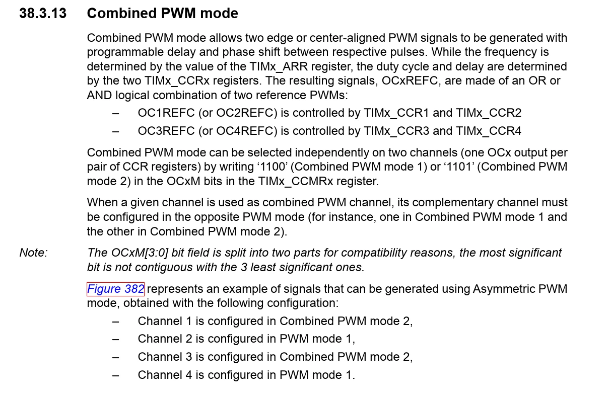

>combined mode but that didn't work
So you set it wrong .
read rm:

Use the Combined PWM mode.
October 11, 2024
How can I do that I'm change pwm as combined mode but that didn't work
read rm:
