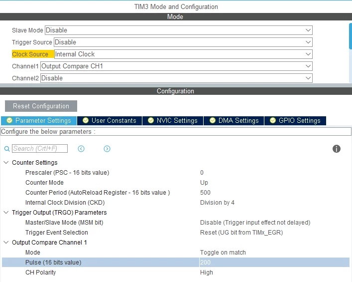

Timer3 generating 5Hz pulse ?
Dear Member,
How can I generate 5Hz pulse on OC using TIM3 ?
Thanks

I got PC6 with LED and it's ON, but I don't know what the frequency is,
The setting is :
TIM3->CR1 |= TIM_CR1_CEN;
      HAL_TIM_Base_Start(&htim3);
      HAL_TIM_OnePulse_Start(&htim3,1);
What do I miss here ?
thanks

Please correct me :
The code :
 htim3.Instance = TIM3;
 htim3.Init.Prescaler = 12;
 htim3.Init.CounterMode = TIM_COUNTERMODE_UP;
 htim3.Init.Period = 10000;
 htim3.Init.ClockDivision = TIM_CLOCKDIVISION_DIV4;
Frequency I got : 2097KHz/(4x10000x12) = 4.3 Hz

htim3.Init.ClockDivision does not do what you think it does. It determines the clock rate on the input filter (if you were using the timer channel as an INPUT, which you are not). It is not another prescaler that divides the timer's input clock to the CNT register, so it has no effect on your output signal.
And is your timer clock really 2.097 MHz?

Apr 2, 2019 1:09 AM UTC
Yes it is 2.097Mhz
Is this setting equal to 5Hz ?
 htim3.Init.Prescaler = 10;
2.097M / *400k
