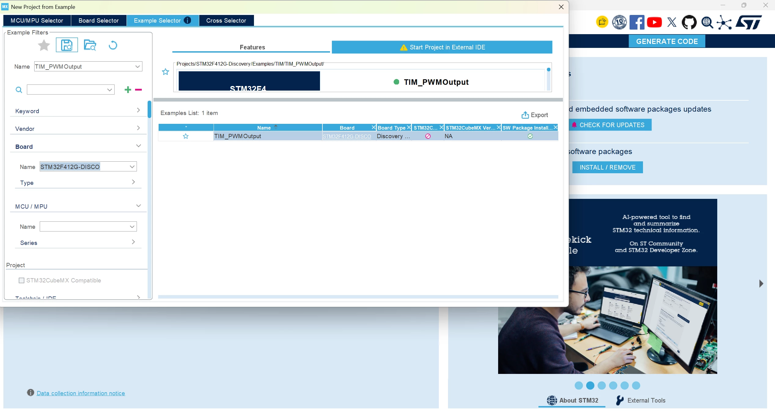

Also, there is a good reference example available: TIM_PWMOutput for STM32F412G-DISCO.
Even if it targets the Discovery board and uses TIM4, it shows the correct HAL startup sequence for PWM generation and can be used as inspiration for TIM1 on your board .
