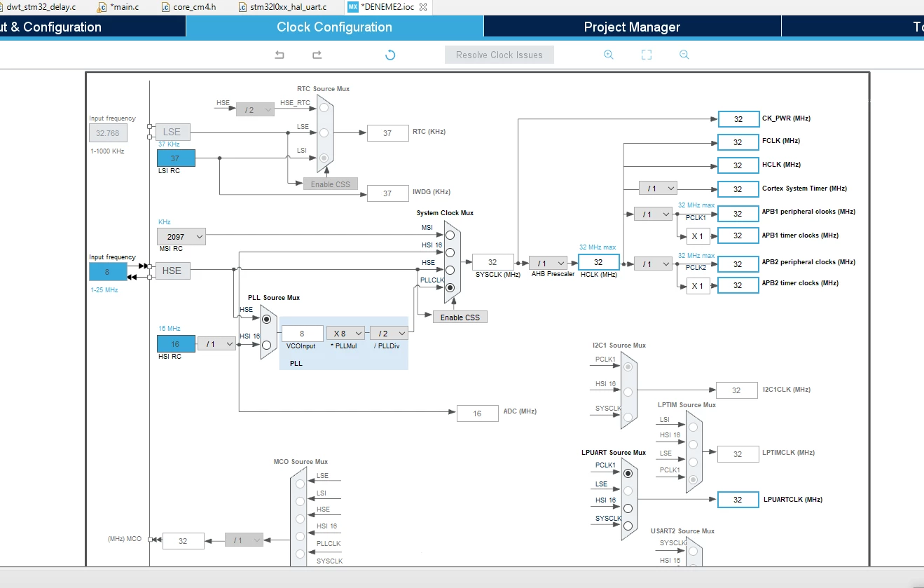

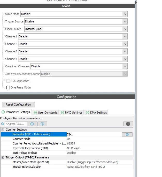

Set TIM ARR to maximal, 0xFFFF
Set TIM PSC to MHZ-1 for APB TIM is on.
CNT will tick in 1us increments, counts 0 thru 0xFFFF
Can't​ interrupt at this high a rate.
