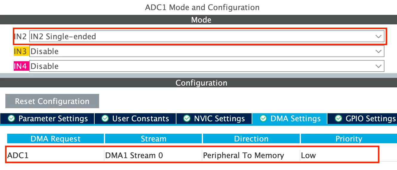

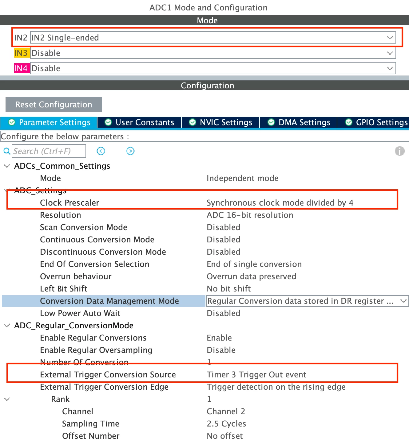

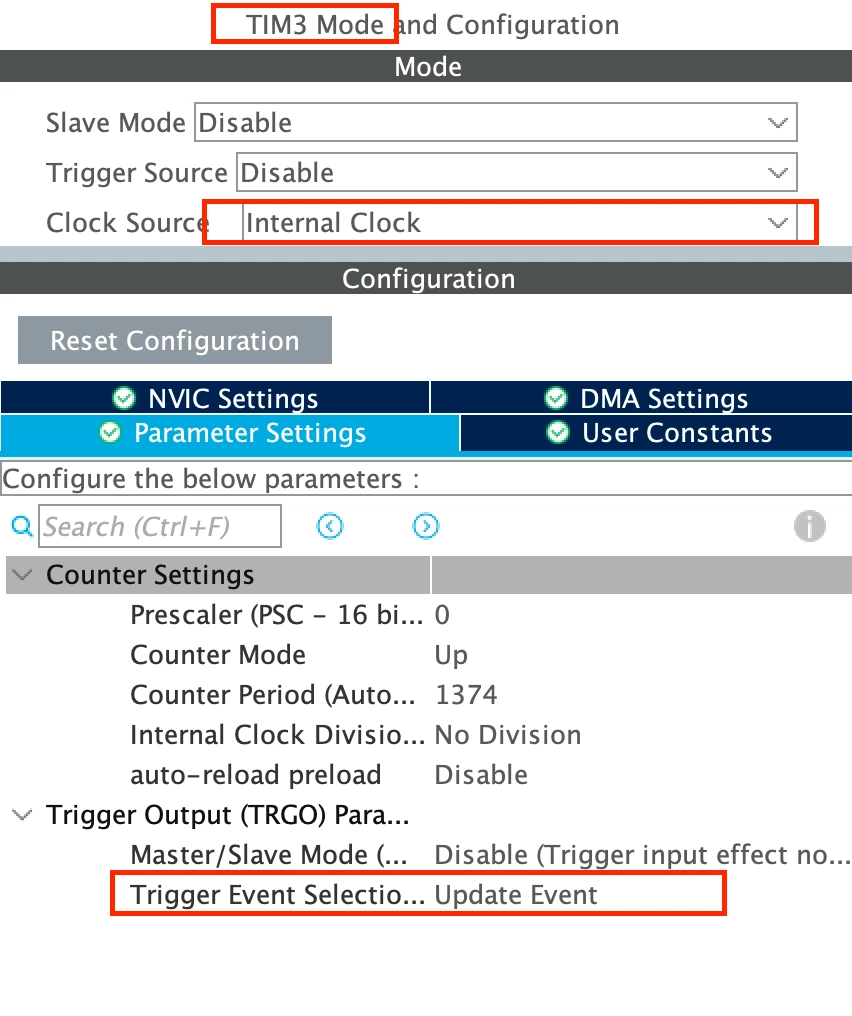

Hi, I hope this message finds you well,
I've been working with the STM32H723ZG and am trying to configure and initialize the ADC to sample at 100khz sampling rate but have been unsuccessful. I have HAL_ADC_ConvSpltCallback() to toggle an LED for debugging purposes. Any help/suggestions will be greatly appreciated!
Here are the steps that I took to initialize the ADC.
Timer Parameter Configuration
ADC1 Parameter Configuration
ADC1 DMA Settings
Variables

Initializations
Tim3
static void MX_TIM3_Init(void)
 /* USER CODE BEGIN TIM3_Init 0 */
 /* USER CODE END TIM3_Init 0 */
 TIM_ClockConfigTypeDef sClockSourceConfig = {0};
 TIM_MasterConfigTypeDef sMasterConfig = {0};
 /* USER CODE BEGIN TIM3_Init 1 */
 /* USER CODE END TIM3_Init 1 */
 htim3.Instance = TIM3;
 htim3.Init.Prescaler = 0;
 htim3.Init.CounterMode = TIM_COUNTERMODE_UP;
 htim3.Init.Period = 1374;
 htim3.Init.ClockDivision = TIM_CLOCKDIVISION_DIV1;
 htim3.Init.AutoReloadPreload = TIM_AUTORELOAD_PRELOAD_DISABLE;
 if (HAL_TIM_Base_Init(&htim3) != HAL_OK)
 Error_Handler();
 sClockSourceConfig.ClockSource = TIM_CLOCKSOURCE_INTERNAL;
 if (HAL_TIM_ConfigClockSource(&htim3, &sClockSourceConfig) != HAL_OK)
 Error_Handler();
 sMasterConfig.MasterOutputTrigger = TIM_TRGO_UPDATE;
 sMasterConfig.MasterSlaveMode = TIM_MASTERSLAVEMODE_ENABLE;
 if (HAL_TIMEx_MasterConfigSynchronization(&htim3, &sMasterConfig) != HAL_OK)
 Error_Handler();
 /* USER CODE BEGIN TIM3_Init 2 */
 /* USER CODE END TIM3_Init 2 */
ADC1
static void MX_ADC1_Init(void)
 /* USER CODE BEGIN ADC1_Init 0 */
 /* USER CODE END ADC1_Init 0 */
 ADC_MultiModeTypeDef multimode = {0};
 ADC_ChannelConfTypeDef sConfig = {0};
 /* USER CODE BEGIN ADC1_Init 1 */
 /* USER CODE END ADC1_Init 1 */
 /** Common config
 hadc1.Instance = ADC1;
 hadc1.Init.ClockPrescaler = ADC_CLOCK_SYNC_PCLK_DIV4;
 hadc1.Init.Resolution = ADC_RESOLUTION_16B;
 hadc1.Init.ScanConvMode = ADC_SCAN_DISABLE;
 hadc1.Init.EOCSelection = ADC_EOC_SINGLE_CONV;
 hadc1.Init.LowPowerAutoWait = DISABLE;
 hadc1.Init.ContinuousConvMode = DISABLE;
 hadc1.Init.NbrOfConversion = 1;
 hadc1.Init.DiscontinuousConvMode = DISABLE;
 hadc1.Init.ExternalTrigConv = ADC_EXTERNALTRIG_T3_TRGO;
 hadc1.Init.ExternalTrigConvEdge = ADC_EXTERNALTRIGCONVEDGE_RISING;
 hadc1.Init.ConversionDataManagement = ADC_CONVERSIONDATA_DR;
 hadc1.Init.Overrun = ADC_OVR_DATA_PRESERVED;
 hadc1.Init.LeftBitShift = ADC_LEFTBITSHIFT_NONE;
 hadc1.Init.OversamplingMode = DISABLE;
 if (HAL_ADC_Init(&hadc1) != HAL_OK)
 Error_Handler();
 /** Configure the ADC multi-mode
 multimode.Mode = ADC_MODE_INDEPENDENT;
 if (HAL_ADCEx_MultiModeConfigChannel(&hadc1, &multimode) != HAL_OK)
 Error_Handler();
 /** Configure Regular Channel
 sConfig.Channel = ADC_CHANNEL_2;
 sConfig.Rank = ADC_REGULAR_RANK_1;
 sConfig.SamplingTime = ADC_SAMPLETIME_2CYCLES_5;
 sConfig.SingleDiff = ADC_SINGLE_ENDED;
 sConfig.OffsetNumber = ADC_OFFSET_NONE;
 sConfig.Offset = 0;
 sConfig.OffsetSignedSaturation = DISABLE;
 if (HAL_ADC_ConfigChannel(&hadc1, &sConfig) != HAL_OK)
 Error_Handler();
 /* USER CODE BEGIN ADC1_Init 2 */
 /* USER CODE END ADC1_Init 2 */

 HAL_ADC_Start_DMA(&hadc1, adc_buffer, ADC_BUF_SIZE);
 HAL_TIM_Base_Start(&htim3);
HAL_ADC_ConvCpltCallback()
void HAL_ADC_ConvCpltCallback(ADC_HandleTypeDef* hadc)
	HAL_GPIO_TogglePin(GPIOE, GPIO_PIN_1); //Yellow LED
2 replies
AScha.3
April 15, 2024
i do almost same - but start timer first, then call ADC_start-dma.. try.
What is then in adc_buffer array ?
coolsocksAuthor
April 15, 2024
Hey!
I tried the flipping the two initializations with no success :(. adc_buffer is the array that I want to fill with data using the ADC.
Other things I've tried:
1. Tried adding the pointer to the parameter.
    HAL_ADC_Start_DMA(&hadc1, (uint32_t*)adc_buffer, ADC_BUF_SIZE);
2. Tried making the buffer an array of uint16_t
    uint16_t adc_buffer[ADC_BUF_SIZE];
