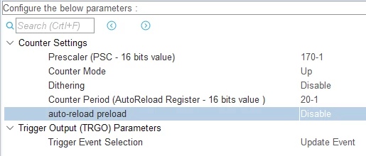

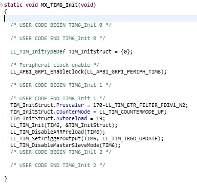

I am not sure if this should be in github or here. But I encounter erroneous code when I use math operation on Timer Prescaler setting, details are below
Describe the set-up
  • The board : NUCLEO-G474RE
  • IDE or at least the compiler and its version : CubeIDe 1.5.1 and CubeMX 6.1.1-RC2, F1.3.0
  • Win10
Describe the bug
TIM6 LL in CubeIDE/MX prescaler cannot use math operation like 170 - 1, (170-1), 170-2, etc.
This is not a problem with ARR.

Hello @victagayun​
Thanks for your feedback, I'll check it then I'll get back to you.
Khouloud
Khouloud ZEMMELI
February 24, 2021
You're right, I have reproduced the issue on my side and it will be fixed.
Thank you @victagayun​ for raising this issue to our attention and we're sorry for any inconvenience this may have caused.
