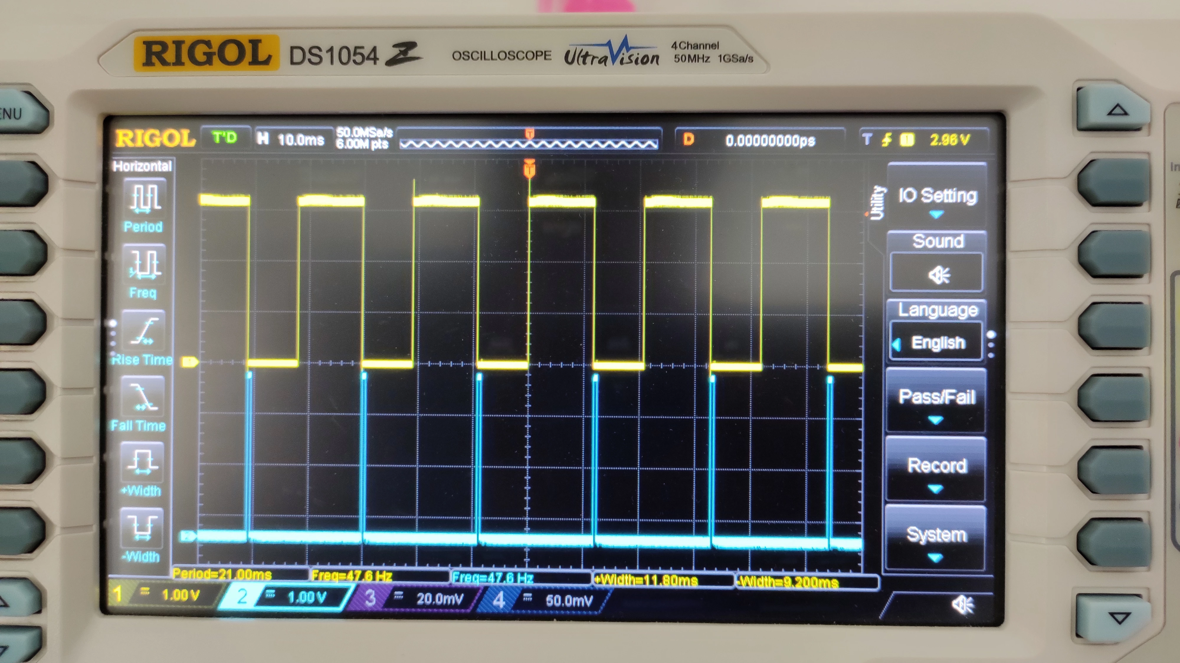

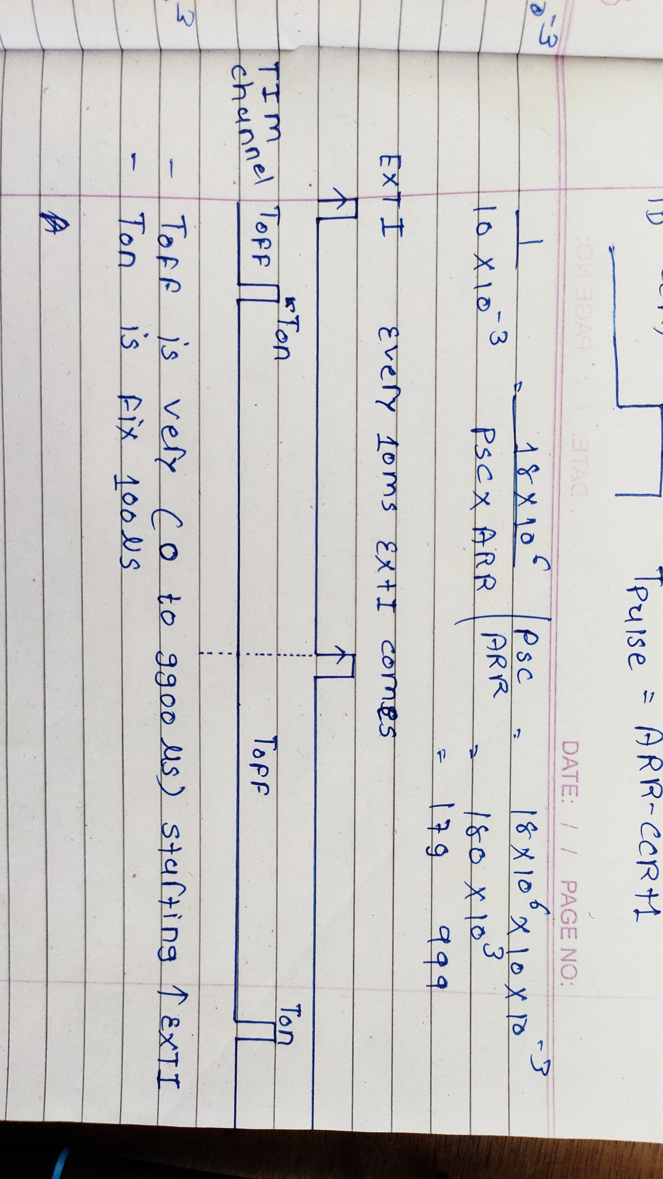

0693W000000UNcIQAW.jpgi want to generate above signal with variable Toff and Ton fix.
i generate code but i don't get my desired out put signal.

in main .c
HAL_TIM_OnePulse_Start(&htim1,TIM_CHANNEL_1);
so how can i generate signal as drawn in 1st image?
what is change in my code.

waclawek.jan
March 21, 2020
Which STM32?
Read out and check/post the TIM registers' content.
berendi
Principal
March 22, 2020
Then do the same with the code I've posted to your previous question, and compare them.
