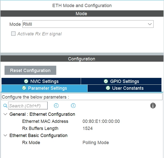

Hello. I'm trying to use Ethernet MAC with external PHY (LAN8720) but when I try to configure the Ethernet on the IOC there is no Advanced Parameters tab (STM32F407VGT6). HAL Lib. version is 1.27.1. I tried a few things but I had no luck. I think I'm missing something but couldn't figure out what. If you could take a look, It would be so helpful. Thanks in advance.

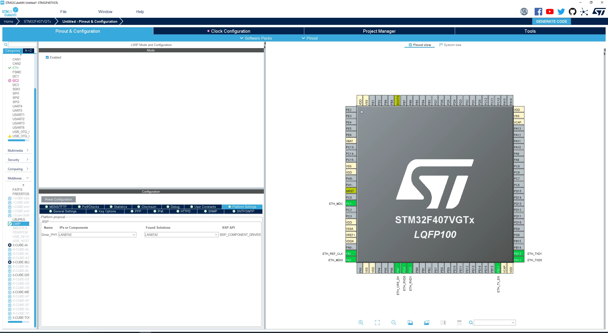

Ghofrane GSOURI
Apr 3, 2023 2:04 PM UTC
Hello @MrEmou​
Actually , you need also to activate the LWIP and then go to Platform settings and choose your external phy as shown in the screenshot
0693W00000bhPphQAE.pngThx
Ghofrane
MrEmou
MrEmouAuthor
Apr 3, 2023 2:12 PM UTC
Thank you for the response @Ghofrane GSOURI​
I believe that this is caused by the reworking of the Ethernet library.
However when I look at the old IOC configuration, it was possible to setup a different PHY, other than the two ST provides.
I want to use LAN8720 but there isn't a solution for that. Is there another way for using another PHYs?
Also do you know if there any Ethernet examples for the new library?
