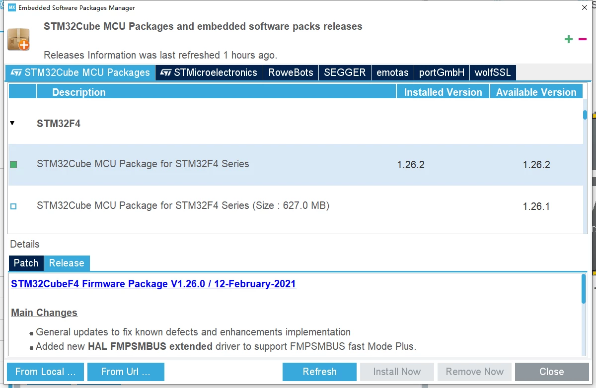

0693W00000Ly3vJQAR.pngHi,
I'm using stm32CubeMX to configure my STM32F429IITx device but the generated driver doesn't work , I have to substitute by example's driver program. My board cannot call SVC handle so that my RTOS doesn't startup ,I have to use system_stm32f4xx.c‘ old driver instead (unknown version). My I2C, DMA,uart all of cannot work if I dont switch to example driver.
Here is my Cubemx capture.

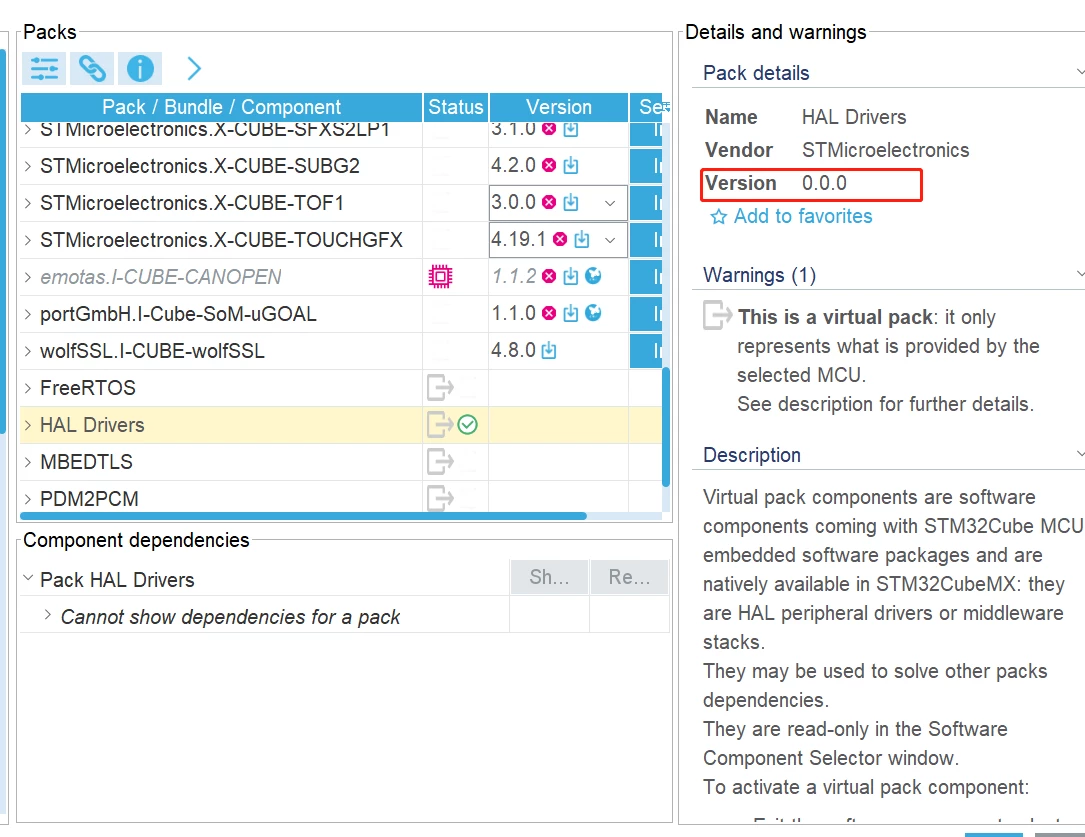

April 18, 2022
  1. "Doesn't work" isn't a sufficient description. What doesn't work about it?
I call some of the generated driver API has no effect, for example I sended I2C data through DMA but slave device didn't receive any data. However,slave device can receive data after I copy files under STM32F4xx_HAL_Driver of example project to my project. I think its my HAL driver has some wrong files.
  1. my device stuck when call "svc 0", and rtos works well after copy system_stm32f4xx.c from example project. two system_stm32f4xx.c files has any differences?
  2. I have to copy "stm32f4xx_hal_i2c.x" as well.
