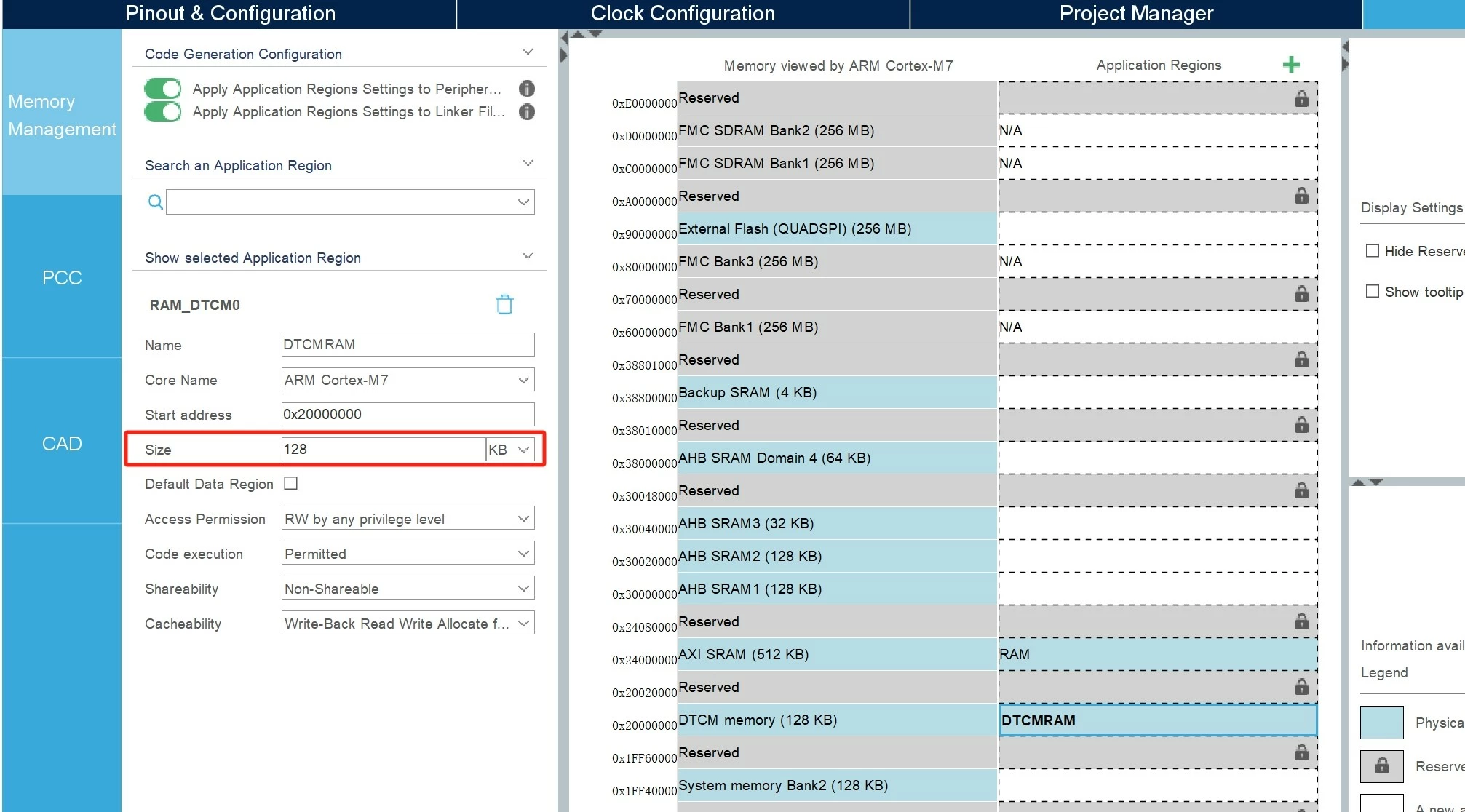

The memory management function of CubeMX's Tools has problems.

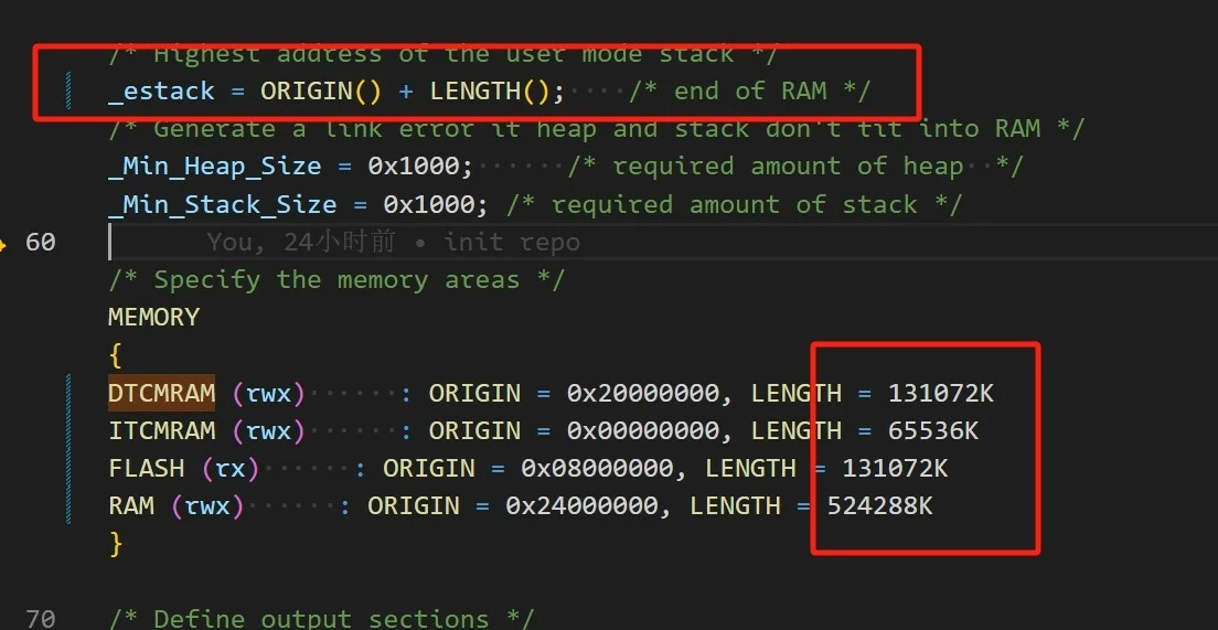

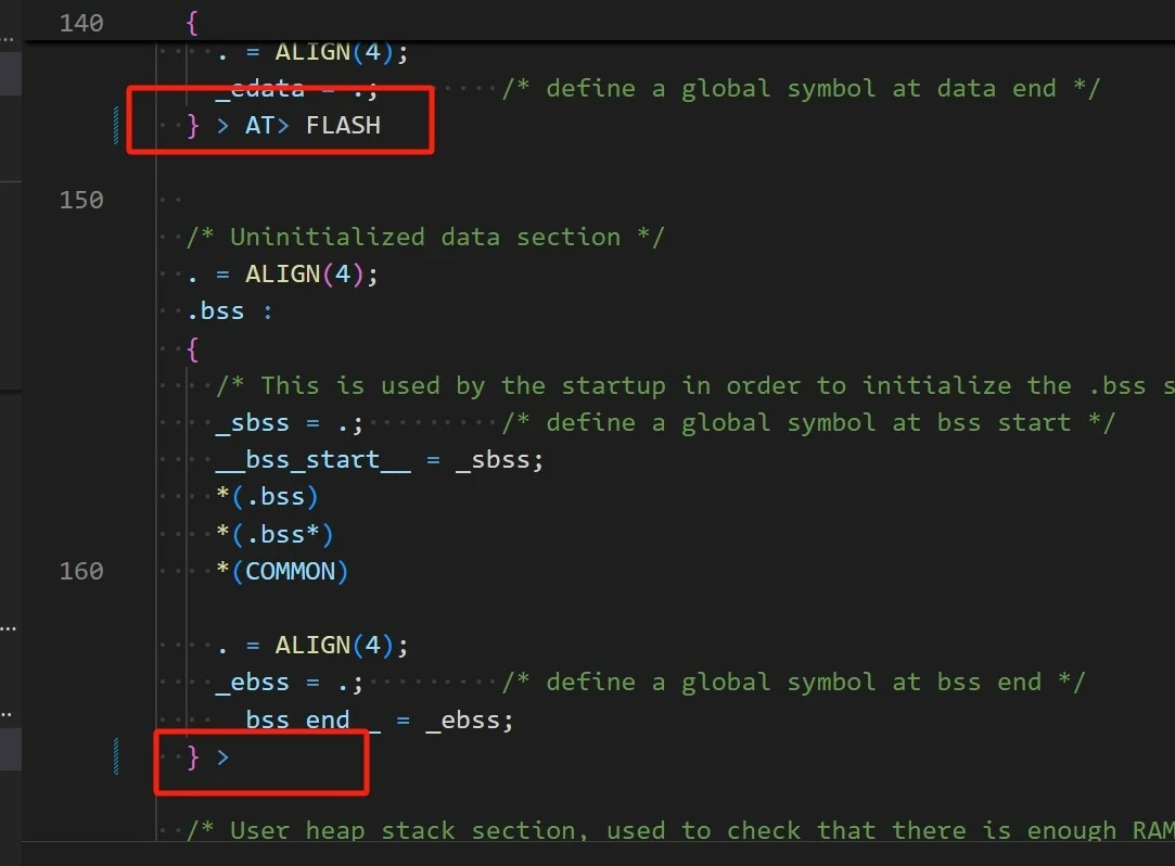

I use the memory management function to generate a custom ld file, but the generated ld file is wrong.

After checking, it seems that the issue is related to the MMT with CMake project.
Actually, the Cmake toolchain was added recently in CubeMX, but it currently does not support MMT. The support of MMT with the Cmake project in CubeMX is planned for the next releases.

and Attached is my ioc file
