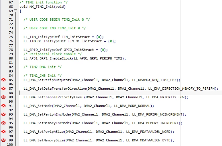

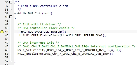

The LL library generates wrong code for DMA2
STM32CubeMx 6.12
Package for STM32G0 1.6.2
STM32G0B1CBT6, Timer PWM DMA2 LL Generates wrong code as follow

Hello @wyb ,
First let me thank you for posting and welcome to the ST Community.
For more investigation, I suggest that you provide your IOC.File.
Thanks.
Mahmoud

Hello @wyb
Thank you for reporting.
This issue is submitted internally to the Dev team for correction (under ticket number : 188355) and it will be fixed ASAP.
Thanks.
Mahmoud
