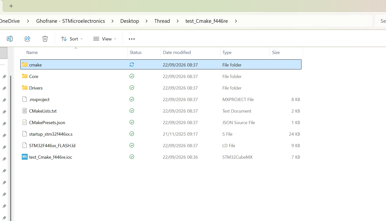

STM32CubeMX is generating the linker script in the project generation root
which is why the original generated line assumes the linker file is at the project root.
If you later move the .ioc and generated files into subdirectories such as target/nucleo_f446re and target/g051, CubeMX does not automatically update that linker path to match your custom folder structure. In that context, your fix is correct: using ${CMAKE_CURRENT_LIST_DIR} makes the linker script path relative to the generated gcc-arm-none-eabi.cmake file, which is more appropriate for a target-specific layout than ${CMAKE_SOURCE_DIR}. The main caveat is that this file is generated by STM32CubeMX, so your modification may be overwritten the next time code is regenerated.
