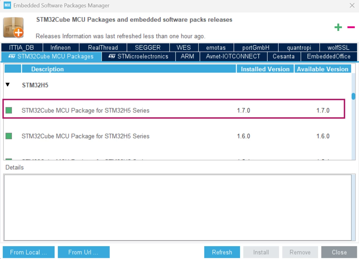

The latest H5 repository 1.7.0 is "Not available"
I was attempting to follow the STM32H563ZI video but I cannot get the current repository for the STM32H5.
I want it to upload it but ti comes back with a failure
What steps do I need to take to fix this?

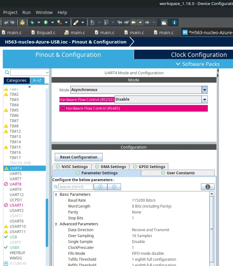

@warm38 ,
uart4…
again: just try IDE 1.19. ; dont need separate Mx then, its included.

Hello ​@warm38
Let me thank you for posting.
For more investigation, could you please specify the STM32CubeMX version.
Knowing that I was able to install successfully the STM32H5 Package with STM32CubeMX 6.18.1.
I recommend that you set the network connection before installing the package.
I will be waiting for your feedback.
Thanks.
Mahmoud

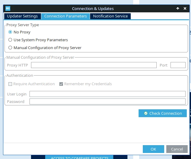

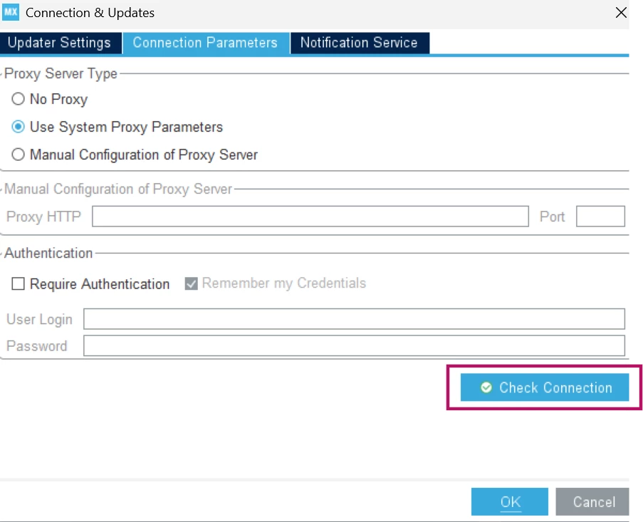

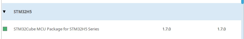

Oct 2, 2026 1:54 PM UTC
STM32CubeMX 6.18.1
STM32CubeIDE 2.2.0
Yes, I “Use System Proxy Parameters”
I do have a directory in my Repository named “STM32Cube_FW_H5_V1.7.0”, but that is not recognized.  How it got there, I haven’t a clue. There is no stm32cube_fw_h5_v170.zip and I can’t get it.  I do have stm32cube_fw_h5_v130.zip, but STM32CubeMX has no interest in that one. If I knew where st.com hides the file, I could manually download it. Any hints?
While stumbling around I did see the “Connection & Updates”, but I don’t know how to get back to that to “Check Connection”.  I need a clue to that as well.

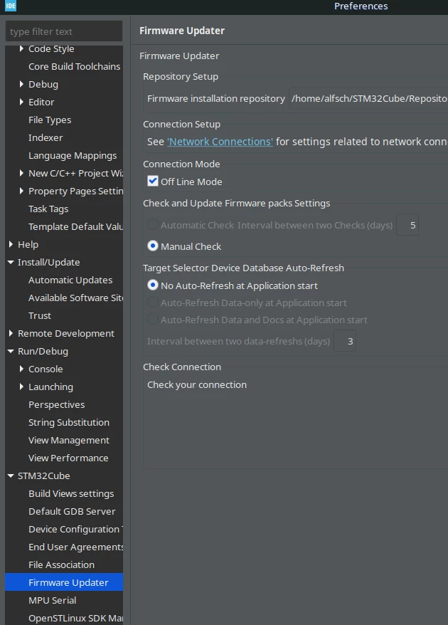

ed. sorry, this for IDE 1.18xxx ; just see, you use new ide 2.xxx .
so for Mx6.18  menu >help> conn.&update
set your login here. then try again…
you should see then in your project : software pack manager >
updates + check conn.
menu > window > preferences -- then >
to get the download in Mx , you have to login :
menu > help > updates > connect. to stm ….login there. then try again…
