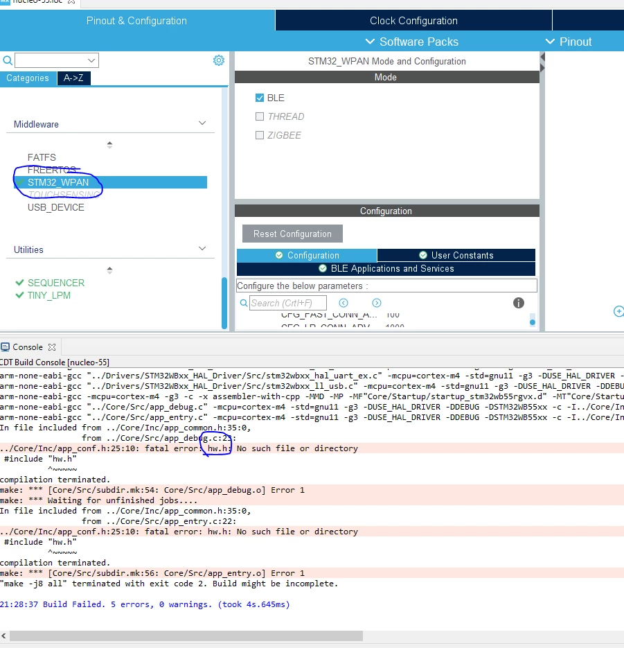

The compiler cannot find hw.h when I enable the STM32_WPAN middleware.

Hello @AAoe.1​ ,
Could you please share your ioc file to check more your problem?
Thanks, Khouloud

Yes! Here you go...

Hello @AAoe.1​
Thanks for sharing your project, I have checked on my side (I enabled the BLE without any change because in the ioc shared its activation was missed), I did not reproduce the issue and the hw.h file is well generated in the project under \Middlewares\ST\STM32_WPAN\interface\patterns\ble_thread, could you please check with the Latest CubeMX (6.2.0) and CubeIDE version?
I'll be waiting for your feedback =)
Thanks, Khouloud

Sounds like your Include Paths are not correctly configured:
https://www.avrfreaks.net/comment/2774661#comment-2774661
