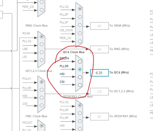

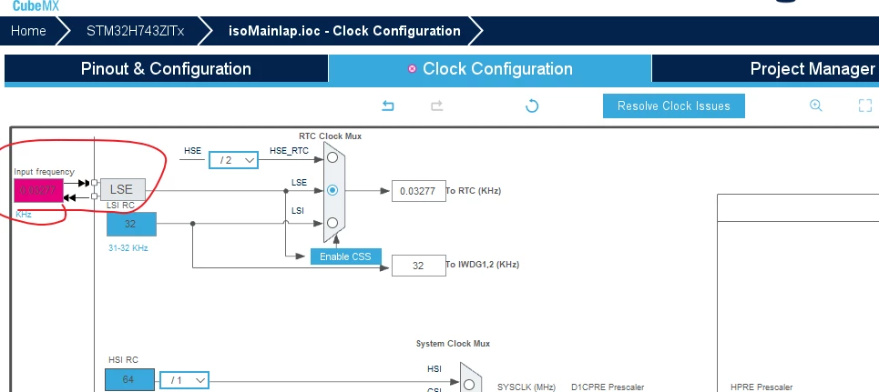

The clock configuration keeps getting an error。

Change the clock source of i2c4

@sxiao.1 Well... 0.03277kHz at LSE = 32.77Hz. A bit too little...

It changes 32.768k to 0.03277 when Change the clock source of i2c4。I didn't modify it
mƎALLEm
June 19, 2024
So you didn't describe very well the issue from the beginning.
As I understood, in CubeMx, you set LSE clock to 32.768Hz. When you enable I2C4, an issue appears on LSE clock. Is that what you are facing as a problem? please be more specific and clear with your descriptions, what is the H7 part number? is that possible to share the ioc file?
