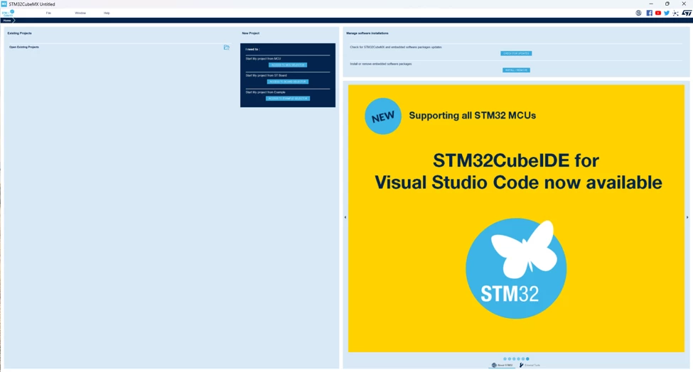

Text size in STM32CubeMX
STM32CubeMX
Is there any way to adjust the size of the text in the left-hand pane?  and maybe the top right as well?  The ad is certainly large enough!

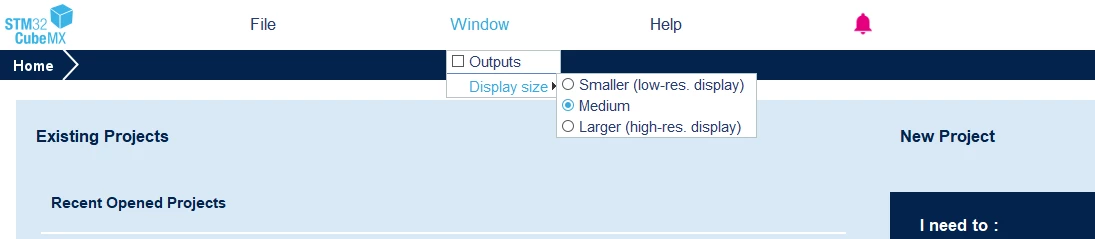

Souhaib MAZHOUDBest answer
Sep 1, 2026 2:26 PM UTC
Hello ​@James B
Have you tried going to Window > Display size and selecting the scale that is most comfortable for you?
BR, Souhaib
