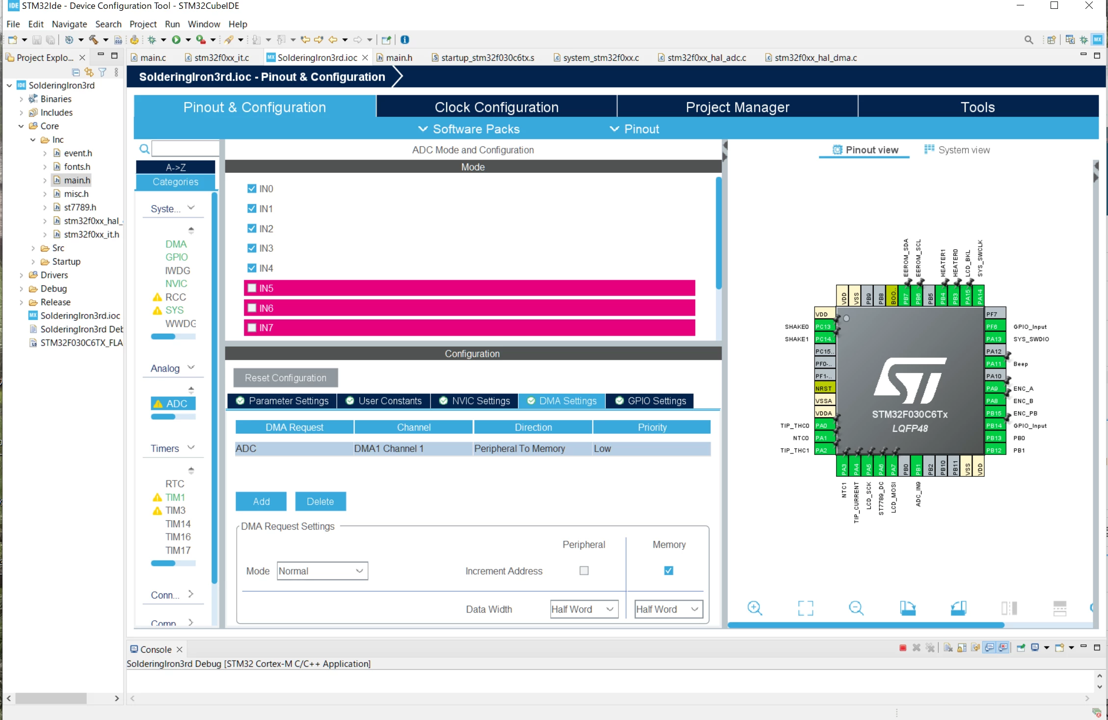

Tell me the workaround of STM32F0x0 HAL, multi channel ADC with DMA.
  • June 10, 2022
  • 5 replies
  • 2178 views
STM32CubeIDE Version: 1.9.0
 Multi channel ADC with DMA cannot use on HAL library.
The HAL does not set DMA CCR prorery. MINC, PSIZE and MSIZE are not set any value, (Their all value 0).
Can I set them at application program ?

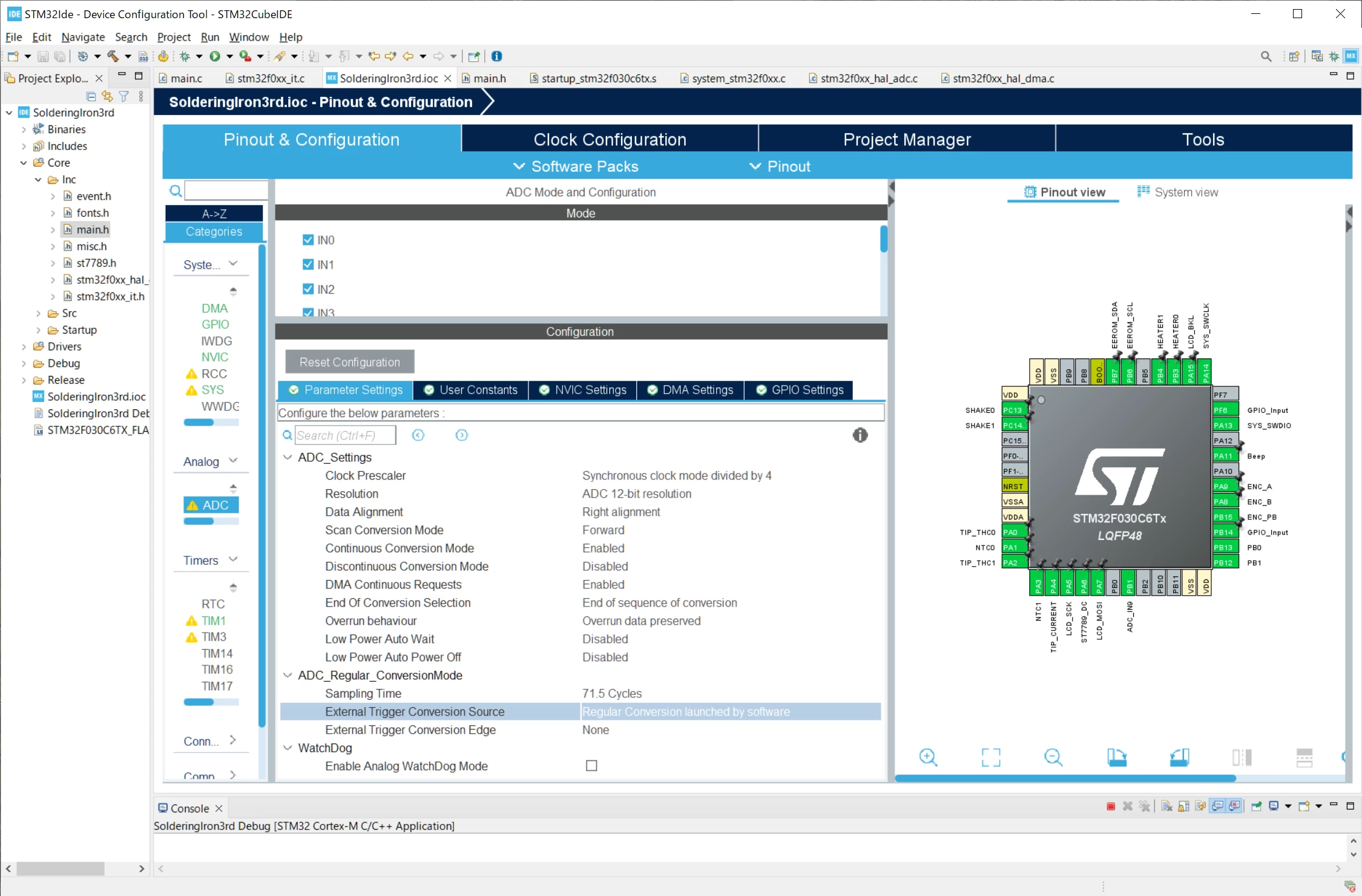

Uploaded my workaround.
hiloling
hilolingAuthor
June 24, 2022
Now, My workaround is as follows.
Add DMA initialize routine( for example, HAL_ADCDMA_SetRegs(&hadc)) after  MX_DMA_Init()
Then "STM32CubeIDE basics - 10 ADC DMA TIM HAL lab" video sample can works well.
code sample (1) (2)
By the way, I finally used ADC sequential discontinuous mode for each 1ms ADC start by (3) in sysclock interrupt service routine after HAL_ADC_Start_DMA.
