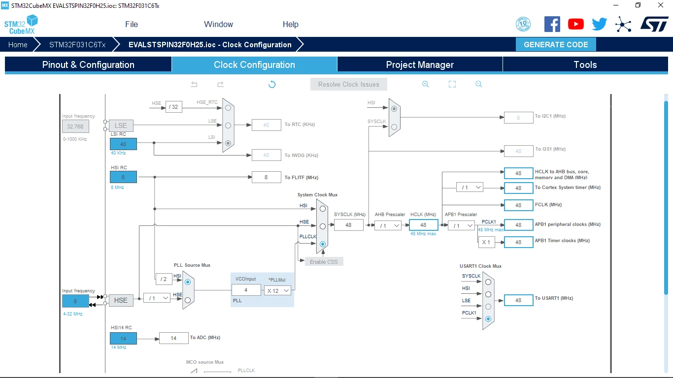

Hi All,
Presently my systick timer is set to 1ms. Does anyone know how to configure that to be set to 1us? Also can It be set such that it increments by 0.1us?
This is the present clock configuration
Here is the present system clock configuration code that I have

KnarfB
October 15, 2021
Technically, you can use
SysTick_Config(SystemCoreClock/10000);
to change the SysTick after its initialization.The parameter is the number of SysClocks sys tick, in the above setting the freq. would be 0.1ms.
But: I wouldn't do that.
First: blocking HAL driver functions and others (FreeRTOS if used,...) are using SysTick and assuming that it runs at 1kHz. E.g. HAL_Delay(1000) will no longer be one second.
Second: The default implementation issues an interrupt after each tick (SysTick_Handler). The MCU load increases with more interrupts per second, and at 48 MHz core clock, a period of 1µs corresponds to only 48 assembler instructions , so the interrupt will consume 100% of the MCU.
This all can be changed and managed, but you better find an unused peripheral timer an program it to your needs.
hth
KnarfB
October 15, 2021
If you need a high resolution timer, create a free-running, preferably 32-bit, timer that runs at the system clock frequency, (or at 1us or 0.1us increments) and doesn't require use of the CPU. Other families can use the CYCCNT counter for this, but it's not available on the STM32F0.
Since SysTick requires the cpu to increment variables, having interrupts at 1 MHz or 10 MHz is not workable.
Tesla DeLorean
Guru
October 15, 2021
NOT VIABLE
You're approaching the challenge from entirely the wrong direction.
