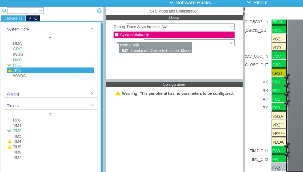

SYS is in conflict with TIM2_CH1
MCU: STM32F105VC

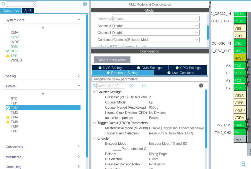

I am going to use TIM2 to operate in encoder mode with two input channels (combined TI1 & TI2).
SYS shows a conflict with TIM2. How can I fix the conflict?
Thank You.
TDKBest answer
Sep 13, 2021 1:01 PM UTC
It means you cannot enable the System Wake Up feature. It doesn't mean there is a current conflict that needs resolved.

Sep 13, 2021 1:04 PM UTC
Thank you.
