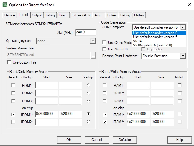

I can generate projects for keil with STMCube but when I choose FreeRTOS and keil, when I choose the compiler version to be V6, the build would fail. is there any work around this?

Hi @ali_dehbidi​
There's an issue related to FreeRtos on 6.0.0, could you please share your ioc file ?

Thanks, Please check the file, If I change the keil internal ARM Compiler to V6, it would fail to build with more than 100 errors! But it would compile fine on V5 of the compiler.

Hello @ali_dehbidi​ ,
After check, Compiler V6 is not supported (it's only supported with L5).

Thanks Khouloud, is there any plan for V6 support?

Hello @Khouloud ZEMMELI​ ,
I too had earlier raised a similar query, but I am unable to find it.
When will STM32CubeMX start supporting generation of MDF-ARM/Keil-compilable code which can be compiled using Compiler version 6?
As per my previous communication the only requirement is to REPLACE the FreeRTOS RVDS folder with the GCC folder.
Please help release this feature request ASAP.
