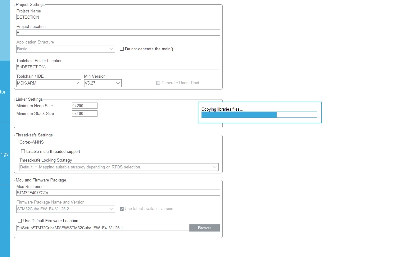

Stuck in "copying library files" while generating code

Java 版本 11.0.20,Cubemx 版本 6.20,路径应该是正确的,但由于某种未知原因它被卡住了。相同的配置可以在另一台计算机上正常运行。

It can run during the first code generation, but it will freeze during the second code generation

I encountered this issue while using Simulink and Cubemx for joint development, and then when I opened Cubemx separately, I found that the generated code would freeze.

Hello @jinhao1
To be able to investigate the issue could you share:
  • the OS version you are working with
  • the *.ioc file
  • the cubemx log file which could be generated when running the tool in CLI:

Thank you very much for your reply. According to the method you provided, I saw that the log shows that there are illegal characters in the path of STM32MatTarget. This can also explain why I had no problem creating the project for the first time, but it kept getting stuck after joint development. My log content is as follows: java.nio.file.InvalidPathException: Illegal char <:> at index 6: .\..\D:\STM32MatTarget\STM32\addSrc\inc
