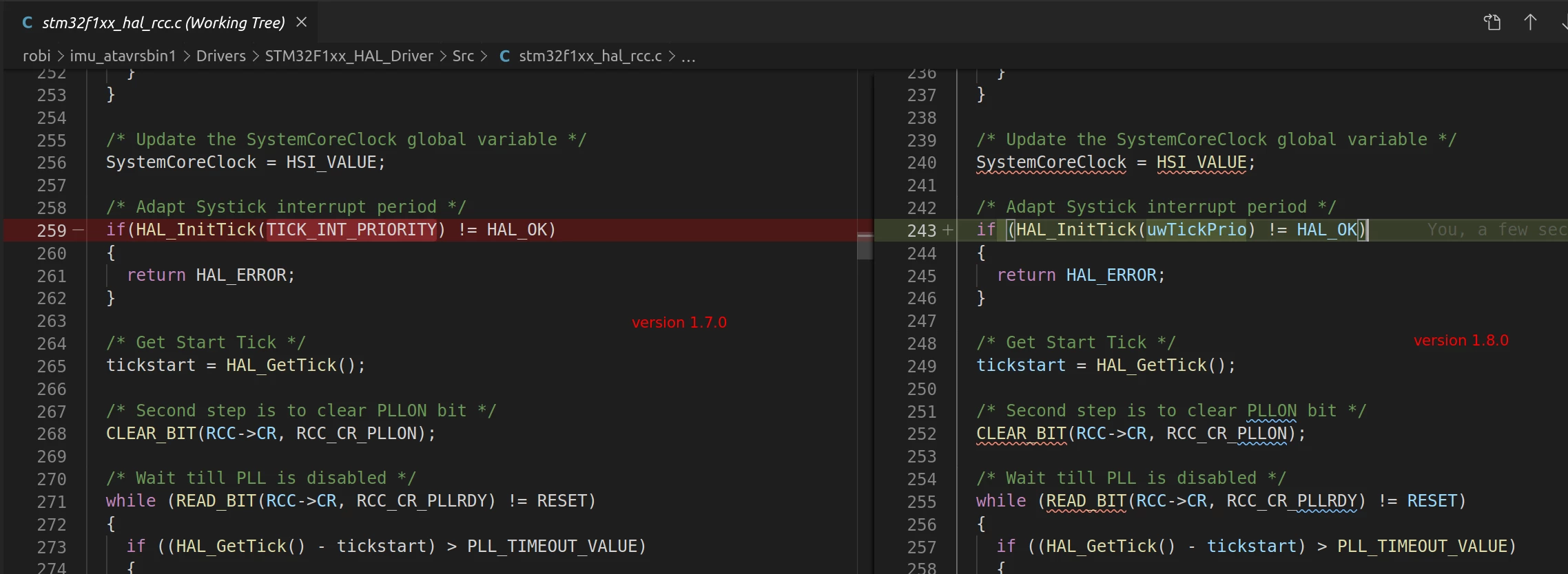

I ran into the same trouble by only updating my F1 firmware from 1.7.0 to 1.8.0.
If we are using a timer TIMx instead of SysTick as time base source the function HAL_InitTick() of the module stm32f1xx_hal_timebase_tim.c is overwriting the weak defined function of module stm32f1xx_hal.c !!!
Unfortunately the HAL_InitTick() function of stm32f1xx_hal_timebase_tim.c does not set the global variable uwTickPrio and therefore the assert check fails because uwTickPrio is initialized in stm32f1xx_hal.c with an invalid value
/** @defgroup HAL_Private_Variables HAL Private Variables
__IO uint32_t uwTick;
uint32_t uwTickPrio = (1UL << __NVIC_PRIO_BITS); /* Invalid PRIO */
HAL_TickFreqTypeDef uwTickFreq = HAL_TICK_FREQ_DEFAULT; /* 1KHz */
As a result module stm32f1xx_hal_rcc.c is calling HAL_Init_Tick() with an invalid uwTickPrio value as argument:

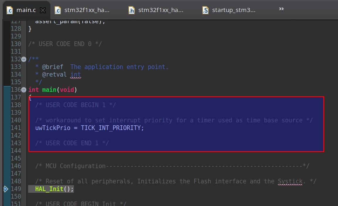

As a workaround you can initialize uwTickPrio = TICK_INT_PRIORITY; in the generated main.c file like:

Same issue using TIM6 as system timer.
Used STM32CubeMX v6.0.1 to generate code and uwTickPrio never gets set anywhere beyond the default invalid value:
stm32f4xx_hal.c defines uint32_t uwTickPrio  = (1UL << __NVIC_PRIO_BITS); -- Invalid PRIO --
In the generated code uwTickPrio never gets assigned a proper value, causing crash when calling
SystemClock_Config()->HAL_RCC_ClockConfig()->HAL_InitTick(uwTickPrio)->HAL_NVIC_SetPriority()->assert!
Setting uwTickPrio to appropriate priority level before call to SystemClock_Config() in the /* USER CODE BEGIN Init */ block of the STM32CubeMX generated main() resolves the problem.
