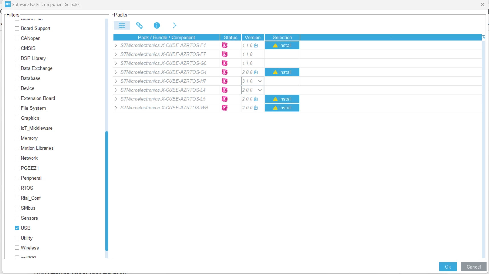

We are devloping application using NUCLEO-H503 , try to install USBX as CDC-ACM port and transfer data to host device ,
1. Try to install Driver for USBX , but not found stmelectronics.xcube-azrtos-h5
How to use NUCLE-H503 USB in Device mode only as CDC-ACM port

Hello @pooja ,
The xcube-azrtos-h5 is not available.
For USBX : Please before enable the THREADX , then you can use the USBX :

Hello  Foued ,
Thanks for your support
NUCLEO-H503 : USB Driver
Import example code from package en.stm32cubeh5-v1-1-0 STM32Cube_FW_H5_V1.1.0-Projects-NUCLEO-H503RB-Applications-USBX-Ux_Device_CDC_ACM
and Run the example using STMcubemx IDE
But gives error for
status = MX_USBX_Device_Init(memory_ptr);
if (status != UX_SUCCESS)
/* USER CODE BEGIN MX_USBX_Device_Init_Error */
while(1)
/* USER CODE END MX_USBX_Device_Init_Error */
Wait in while
Check error status : UX_MEMORY_INSUFFICIENT

 add size
#define UX_DEVICE_APP_MEM_POOL_SIZE 30000
#define USBX_DEVICE_MEMORY_STACK_SIZE 25000
