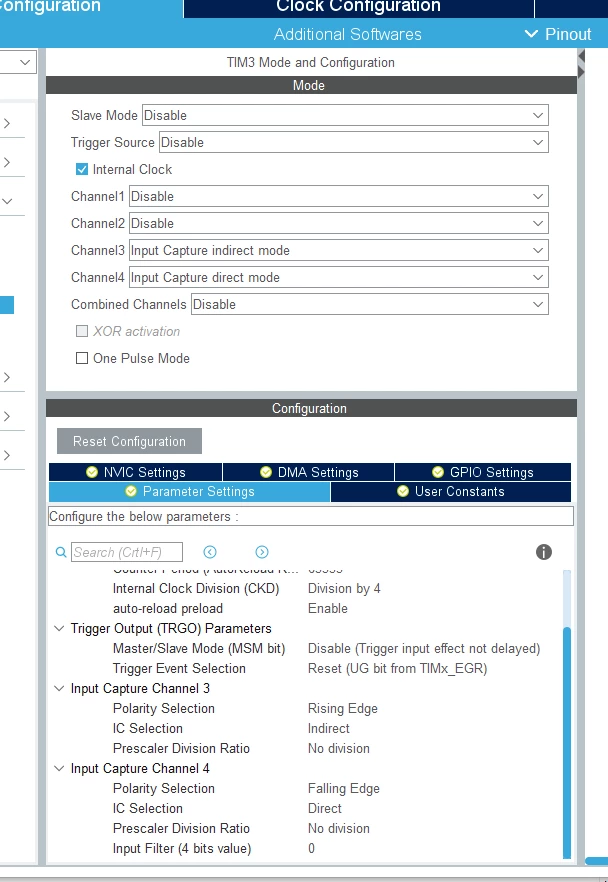

STMCubeMX 5.1.0 Bug Report: Project loading does not load timer configuration correctly.
  • March 25, 2019
  • 920 views
Bug Report STMCubeMX 5.1.0
The tool does not load the timer configuration correctly when channel 4 is "Input Capture direct mode" and channel 3 is "Input Capture indirect mode".
After loading a configuration with these settings channel 3 is set to "Disable". Happens for timer 2 and timer 3.
Attached are a ioc file and a screenshot from the timer configuration.

Workaround:
Does not happen when Pin Stacking is disabled.
I had the timer and GPIO inputs enabled for the same pin.
