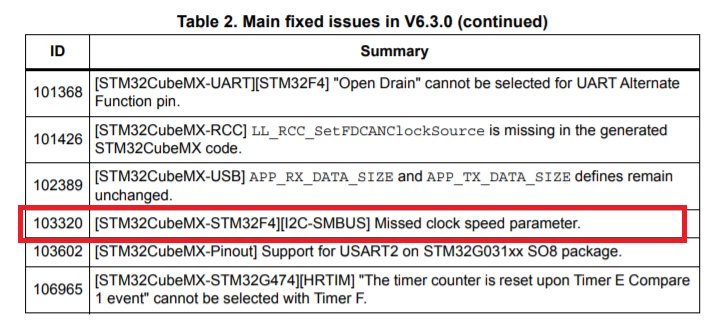

Amel NASRI
Jul 27, 2021 3:03 PM UTC
Hi @Community member​ ,
That is strange as the issue you are reporting is a known one and in STM32CubeMX release note, we confirm that it was fixed with STM32CubeMX 6.3.0:
0693W00000D0mENQAZ.pngI'll try to check this again on my side. Please make sure that STM32CubeIDE is embedding STM32CubeMX 6.3.0.
-Amel
