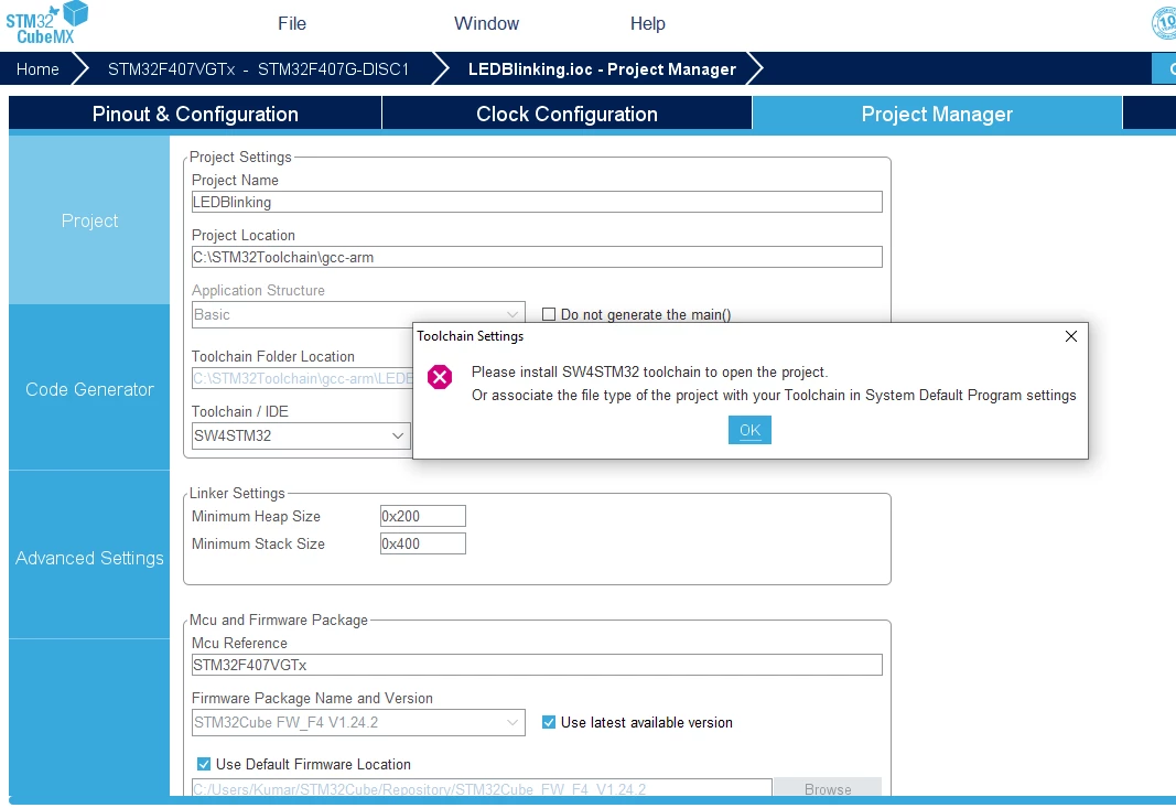

STMCUBE ide error for project generation for Eclipse tool chain
  • December 29, 2019
  • 1 reply
  • 930 views
I want to use STMCube generation tool for project generation. But I am getting the following error. I have installed the required gcc tool chain. Please let me know0690X00000BvT7TQAV.png

KnarfB
January 1, 2020
The Code Generator generates a .project file. This file type must be associated to the STM32CubeIDE. STM32CubeIDE does this usually on its first run. You can open the project folder and associate (Windows speak) the file type manually (right click on .project).
