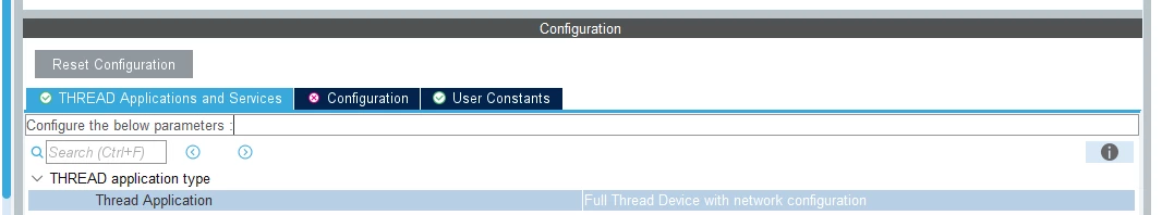

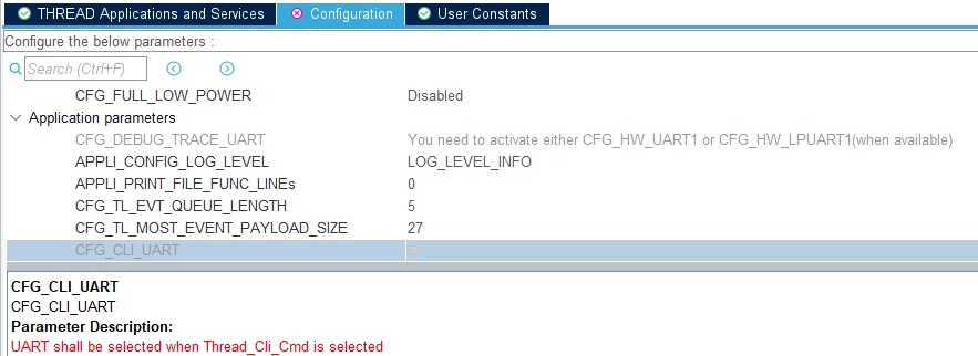

I am trying to set up an STMWB55CGUx device for THREAD. I want to set it up to have no log or CLI interface on any UART. When I select the FTD THREAD application type the CFG_CLI_UART setting is still requiring a UART to be able to auto generate a hw_uart.c file that is useless to me. This essentially blocks off a UART without editing files that could be overwritten via a re-generation.
Is there any fix apart from manually editing auto-generated code?

Further to your comment, you need to enable CFG_HW_LPUART1_ENABLED and CFG_HW_USART1_ENABLED parameters and then set CFG_CLI_UART as hw_uart1 or hw_lpurat1.

My question was not how do I get it working, but why do I have to set the CFG_CLI_UART when I specifically only want FTD and not FTD_CLI? This essentially renders a UART pointless no matter what I choose.
