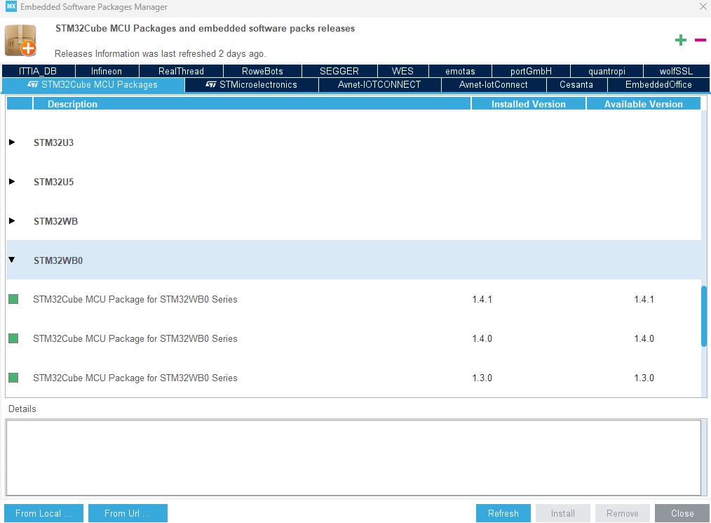

I am currently working on a project using the STM32WB05KNV6TR microcontroller. I am using STM32CubeIDE Version 2.0.0, and I have ensured that all MCU packages and embedded software packs are up to date.

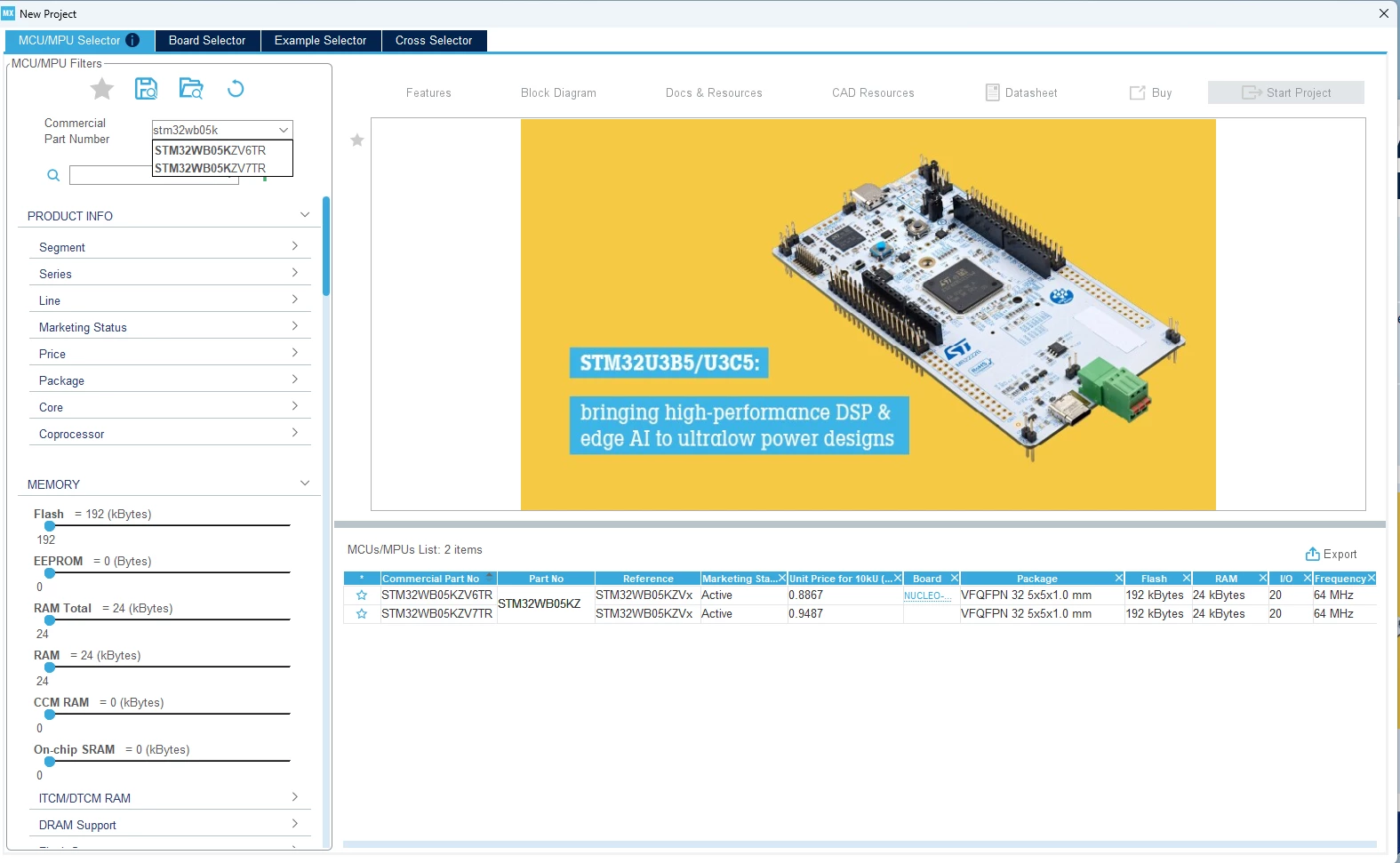

Specifically, as shown in the attached screenshot, I have the STM32Cube MCU Package for STM32WB0 Series (v1.4.1) installed. However, when I try to create a new project and use the Target Selector (MCU/MPU Selector), the STM32WB05 series—and specifically the STM32WB05KNV6TR—does not appear in the list.
I urgently need to access the Pinout & Configuration view to finalize my hardware design and verify the pin assignments.

  1. Updated STM32CubeIDE to the latest available version.
  2. Refreshed and installed the latest WB0 series patches via the Embedded Software Packages Manager.
  3. Restarted the IDE and checked the board/MCU selector filters.

I am sharing our expert’s explanation with you:
The WB05xN is used as a network coprocessor, while the application runs on the host device.
So in STM32CubeMX, you create the project for the Host MCU/MPU, not for the WB05xN.
It is not possible to create an MX project for these CPNs.
