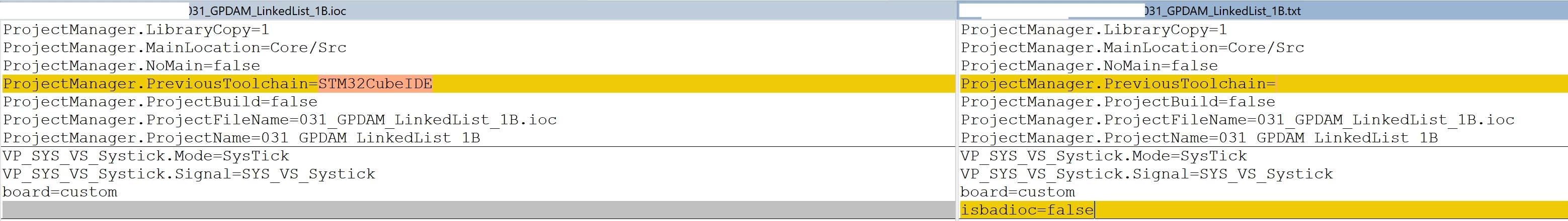

It looks like the toolchain parameter is not properly set in the IOC file that you sent. Setting it to STM32CubeIDE fixes the issue.

Before I generated the code, I edited it with Visual Code and added as you indicated
ProjectManager.PreviousToolchain=STM32CubeIDE
I then saved the file and generated code via STM32CubeIDE, which still reports the error below.
  - Main Config: These peripherals still have some not configured or wrong parameter values: [PWR, RCC]
I inspected the ioc file and it reverted back to blank.
ProjectManager.PreviousToolchain =
How to generate code without clearing it?
Thanks
December 1, 2023
Did you also remove the isbadioc line?
File that works for me is attached.

I have removed the isbadioc line (via Visual code) but now it mask out the Generate Code in the context menu from ioc filename in the STM32CubeIDE. I feel it outsmarted me to make progress!.
