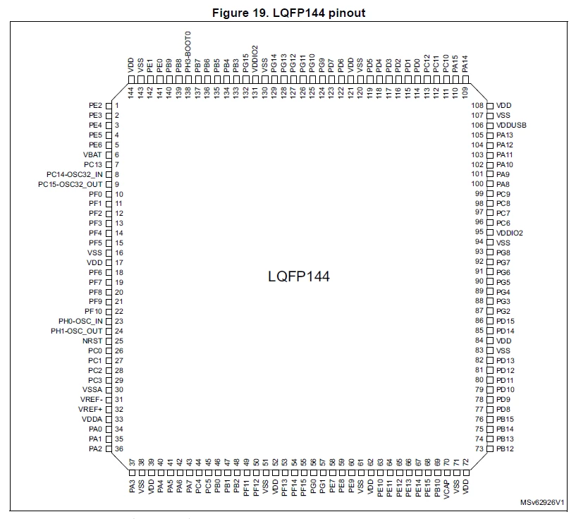

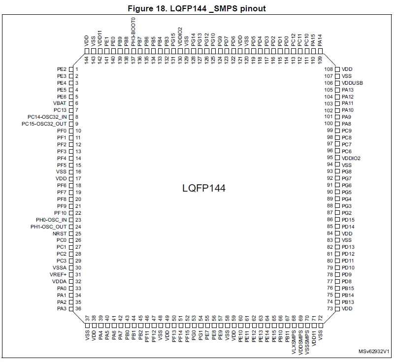

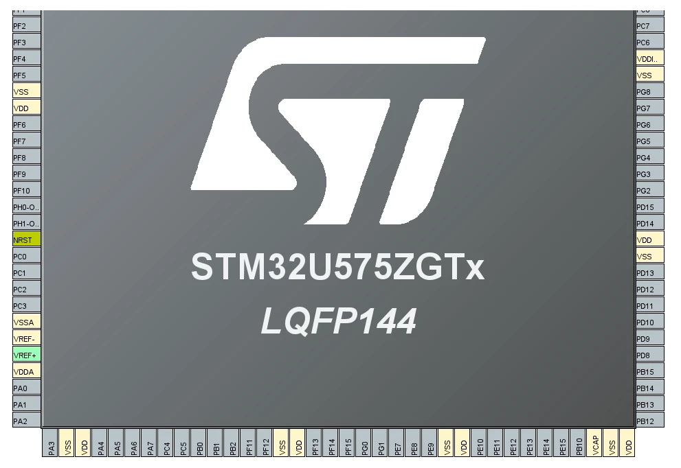

STM32U575Zx has wrong pinout in STM32CubeIDE 1.10.0
I like to use the LQFP144 case of the STM32U575, but unfortunatly the case showed is wrong, see attaced pictures0693W00000QKX2JQAX.jpg0693W00000QKX2EQAX.jpg
AimeBest answer
Jul 6, 2022 7:34 AM UTC
Hi @MHo.15llenweger​ ,
Thank you for your message. ;)

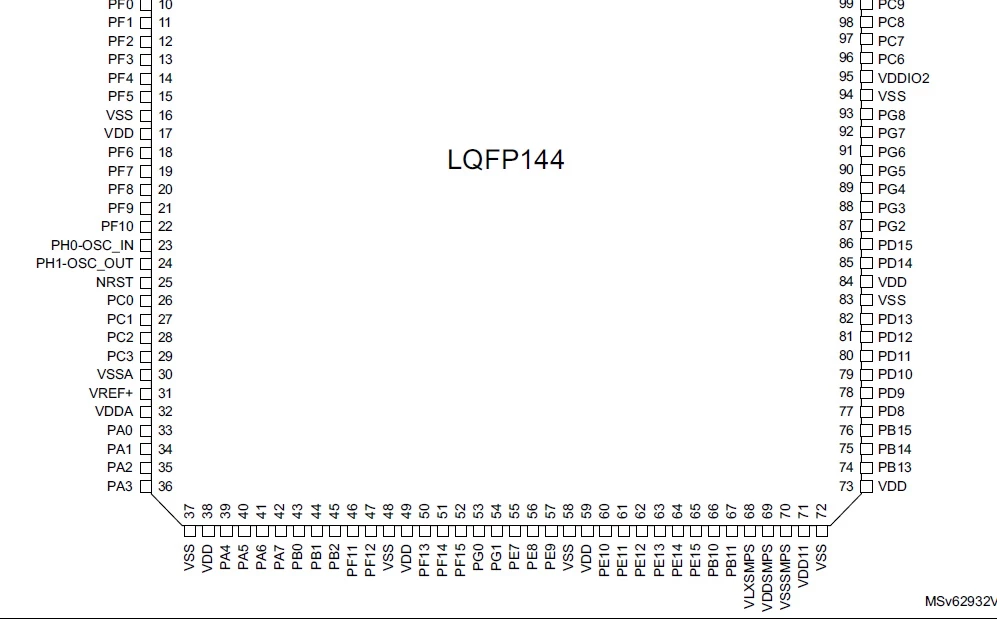

In fact there is no mistake, STM32U575ZGTx is available on LQFP144 package (with SMPS and without SMPS) and with a different pinout.
LQFP144 pinout with SMPS available :
LQFP144 pinout without SMPS, corresponding to your STM32CubeIDE's picture:
Please refer to the section "4: Pinout, pin description and alternate functions" of the attached datasheet.

Thanks for the answer, Your right, I ignored the existence of two different pin-out's for the same case.
Best regards
Martin
