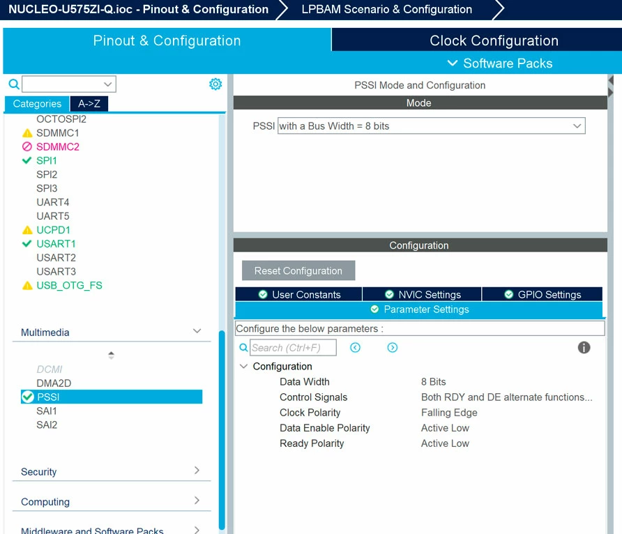

STM32U575 PSSI DMA CubeMX Settings Missing
  • May 10, 2023
  • 1 reply
  • 1548 views
No PSSI DMA settings. Thought that the MCU does not support DMA, but the manual says that it does.
Current STM32Cube MCU Package v1.2.0
1 reply
KDJEM.1
May 22, 2023
Hello @MPhil.4​ and welcome to the Community :),
I confirm the issue: the tab of DMA settings does not exist in the configuration tab.
I reported internally.
Internal ticket number: 131975 (This is an internal tracking number and is not accessible or usable by customers).
Thank you for reporting this issue.
