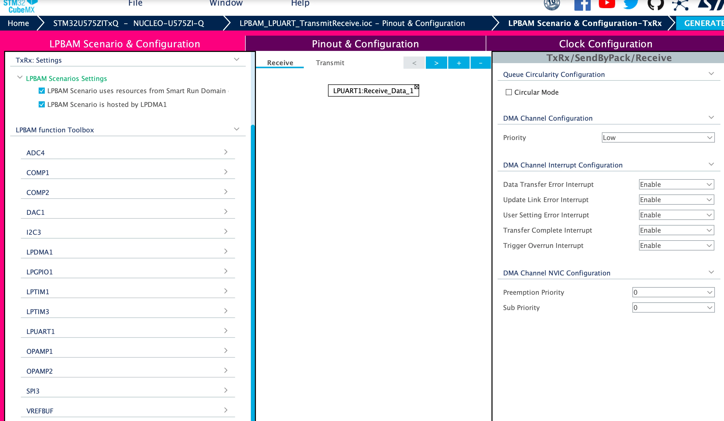

I want to use STM32U5 ADF in LPBAM Mode, I can't see the ADF option in the CUBE MX LPBAM design configuration. I want to use ADF in stop 2 mode with LPDMA and SRAM4 I have the ready code for ADF and LPDMA I wish to operate them in LPBAM Mode.

I am using NUCLEO-U575ZI-Q Board
STM32CUBE Mx Version: 6.8.0
I have attached the image below for your reference as you can see there is no ADF option in LPBAM Configuration.

Hi @SShai.3​ ,
Yes the 6.8.0 is the latest CubeMX version, thank you for noticing this issue.
I will transmit it to the ecosystem team, it will be fixed on the next CubeMX release.

It's been almost a year since SShai.3 reported the issue of the missing ADF peripheral in the CubeMX LPBAM configurator. As of STM32CubeMX version 6.10.0, the ADF1 peripheral is still missing. Is there a limitation in the STM32U5 hardware that is preventing this feature from being implemented? Is there any example code that I could follow to get ADF1 working with LPDMA in STOP MODE 0 and higher?

So can you assist how can i go forward?
As the ADF option is not present in CUBE MX LPBAM Config. How should I generate the startup code for ADF in LPBAM Mode?
I am not getting drivers also for the same.

Anyone out there have information on getting the ADF peripheral working in stop mode with LPBAM? I'd really like to get this figured out. Thanks!
