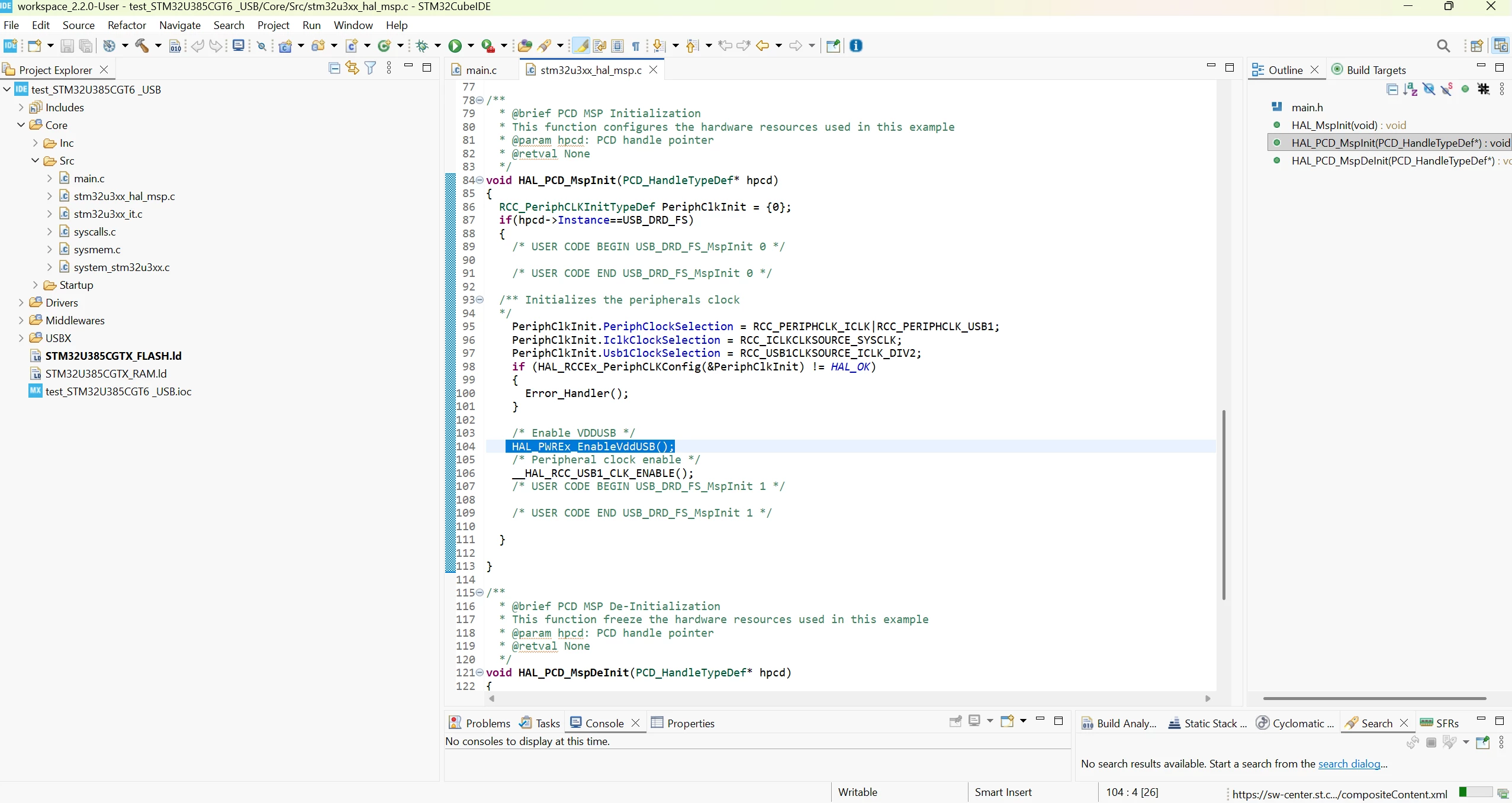

I'm bringing up a USB MSC device on an STM32U385CGT6 with the USBX middleware in standalone mode. Everything comes from CubeMX 6.18.0 with STM32Cube FW_U3 V1.4.0 (USBX 6.4.0): USB_DRD_FS in device mode, USBX Core System + UX Device CoreStack + UX Device Controller + UX Device MSC.
While comparing the generated code and some example applications (NUCLEO-U385RG-Q Ux_Device_HID_Standalone) it looks there is a regression in the generated HAL_PCD_MspInit. While the version from the example application enables Vdd USB, this is missing from the currently generated version of HAL_PCD_MspInit causing the peripheral to remain powered down.
As a fix HAL_PWREx_EnableVddUSB(); can be called in the user code section at the bottom of HAL_PCD_MspInit.

I have performed a test using the latest version of STM32CubeMX 6.18.1 and the line of code does exist in the generated code as shown below
I am sharing with you my IOC.
I will be waiting for your feedback.
THX
Ghofrane

Hi Ghofrane,
Thank you for the fast responce.
I did some tests with your ioc file and i think i found the source of the bug. To reproduce it simply go to “Project Manager → Code Generation → Generated Files” and enable “Generate peripheral initialization as a pair of ‘.c/.h’ files per peripheral”
With it enabled the USB PCD MSP init function lands in usb.c and is missing the HAL_PWREx_EnableVddUSB call.
Best Regards, Cecil
