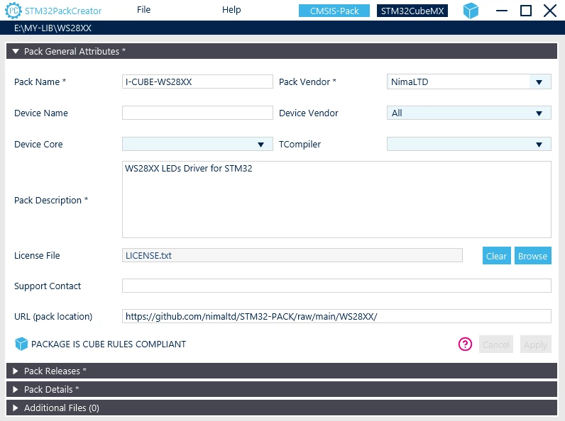

STM32PacketCreator Bug
  • June 29, 2024
  • 0 replies
  • 759 views
When press enter after text on "Packet Description", Packet generated successfuly and did i uploaded to git. but it did not appierd on cube mx. after delete the enter from end of "Packet Description", it worked.
